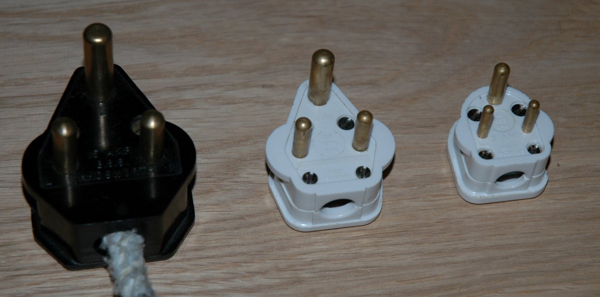

Blimey that's a blast from the past, I remember these as a kid in the 70s
The 15A ones are still used in theatrical lighting, but normally rubber Duraplugs.
As we move over to LED lamps, the electrical load has shrivelled away, so I suppose a time will come when they are no longer needed.

Part of the reason 15A is used in theatre is that they have no fuses
When you have 200 lights above you and one goes out, it's better to know that the various extension leads and bars have no fuses. The dimmer pack will trip
Some schools used 5A because of the smaller loads but for the same reason
Tungsten lamps use a room full of dimmers to control levels
Intelligent LED units only need power on/off and use dmx to tell the light to either change colour or level
Ceforms are becoming popular for LEDs to prevent accidents with dimmed power as although you can programme a lighting desk/dimmer to act as a switch, cockups happen
