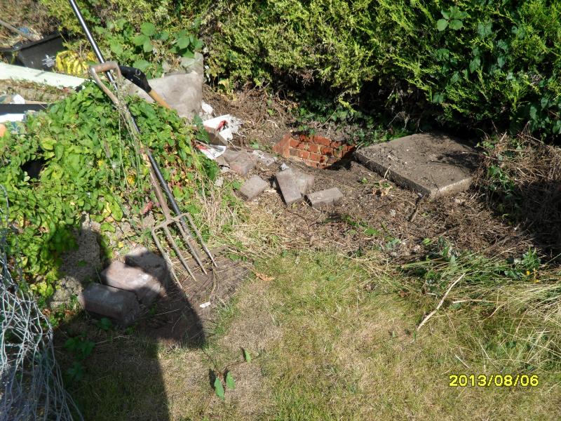

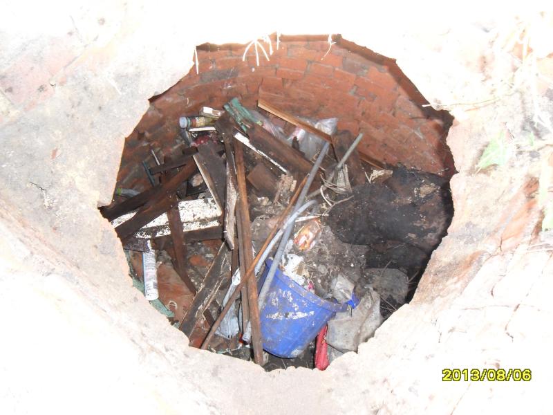

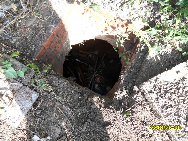

What is this??
Or an old well filled in with rubbish.
Any evidence of an iron hand pump nearby or any iron clips built into the walls as evidence of a dropper pipe, or step irons?
Really? I was thinking more cess pit or well. If its a cess pit I will fill it in (which someone seems to have already started). If its a well I will put a top on it to make it a feature.
if there are any experts out there I would love to know if this is a cesspit or a well - My guess in cesspit because of the manhole cover in close proximity but next door have a well in their garden (although that is an 18th century house) - and I don't know what either look like.
Clear the rubbish out and have a taste of the water at the bottom, you'll soon know the difference :lol:
My money would be on a cesspit. A well would be vertical from the top straight down, whereas a cesspit would be wider with a domed roof to access shaft in the centre.
Certainly some craftmanship in the brickwork, still quite a few about and in use, although their capacity is somewhat limited for modern living.
