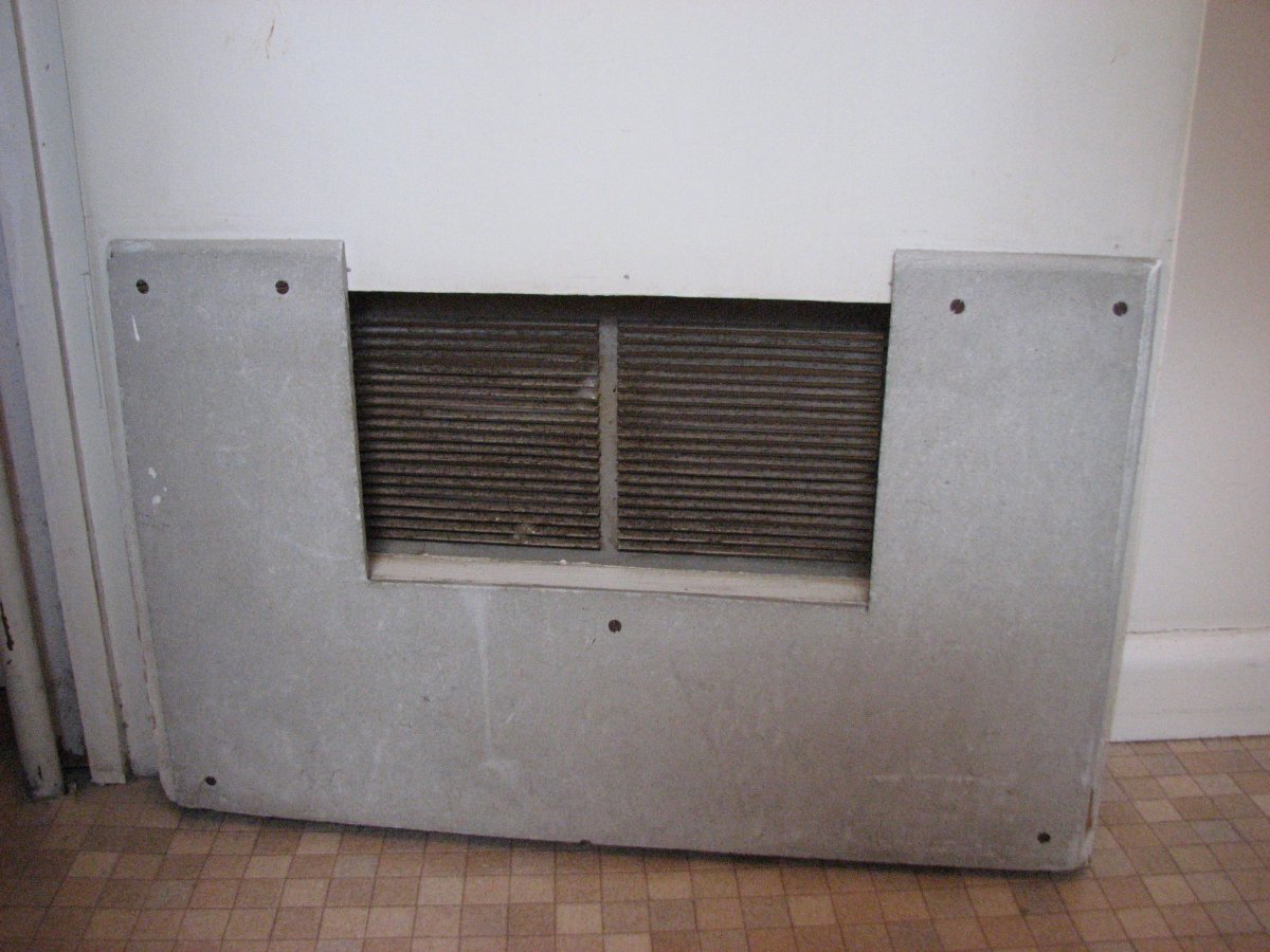

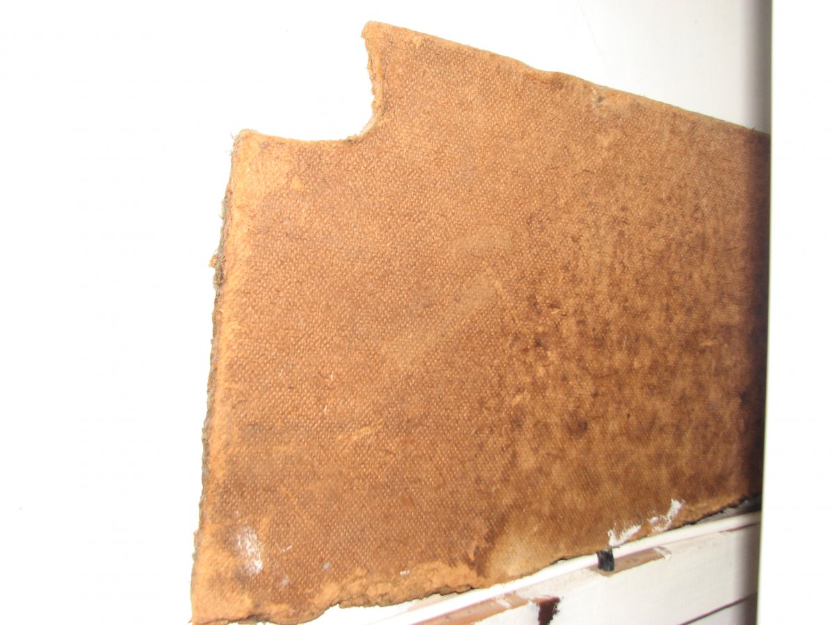

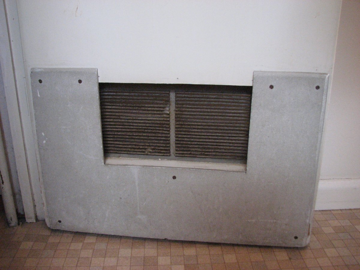

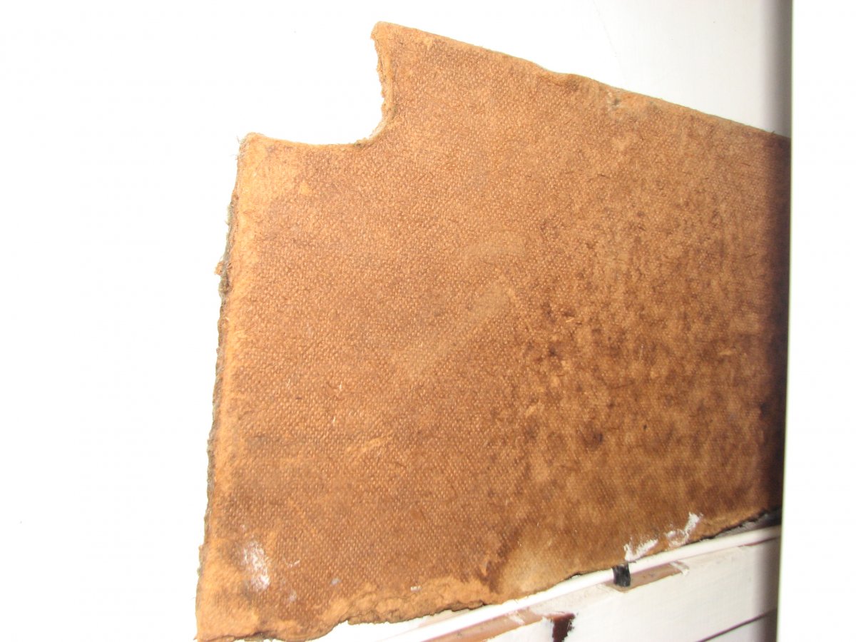

Dear all,
We've just found these materials in our (rented) house. We're wondering what they are, and concerned that they might be asbestos.
Could someone please either reassure us, or confirm our fears?
The brown one seems to be particle board, and harmless.....the second one could be a cemented asbestos sheet called asbestolux, but it's shinier composition could indicate Supalux which replaced the original stuff.
There are many posts concerning this and how it can be tested, because no one can be certain.
Is it around a warm air heating unit or similar?
Either way I wouldn't panic about it, it should be stable and dust free.
John :)
Thanks Now we have your reply we can google images etc.
What we have appears to be fine-grained, like supalux. Images I've found of abestolux seem to show a coarser surface. E.g. the images here: //www.diynot.com/diy/threads/is-this-asbestos.414106/
It was mainly the brown product we were concerned about. There's a lot of that, and it's shedding.
They are both in an airing cupboard which used to have a copper hot water tank in it, but it now has a recent boiler.
Another one of my wacky suggestions is to ask the landlord.
The first image is hardboard with no asbestos. The second image has potential, and it's common for AIB to be used in that location. AIB is the more risky form of asbestos board.
