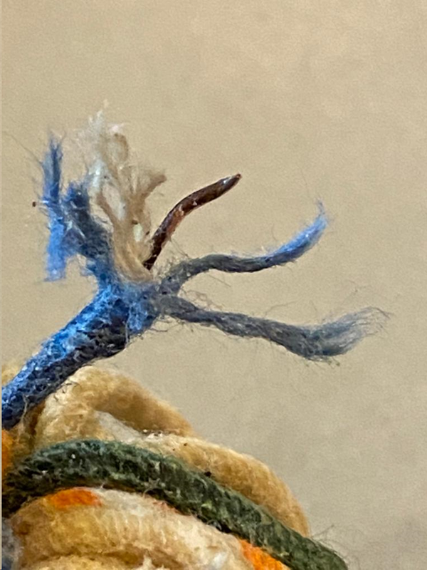

Hi folks, I'm currently trying to get to grips with a house which was built in 1887. Beneath the floorboards are (amongst other things!!) generations of old out-of-service cables,including a lot of VIR and lead-sheathed 'mains' cables.

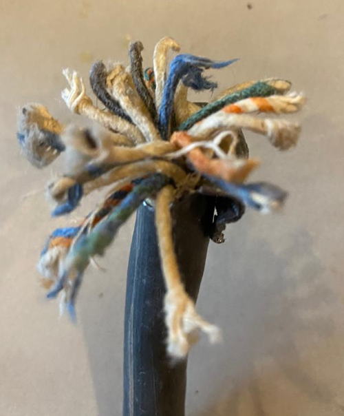

However, there is also a fair bit of cable as per (not very good) photo below. It is lead-sheathed, with an outside diameter of about 12-13mm and contains about 20 solid cores, each with (mainly blue/orange/black) insulation and each wrapped (outside the insulation) with some sort of cotton or suchlike). So far, every bit I've found has got cut ends, with no indication of what it was once connected to.

Thanks. I have to say that, at first sight, the coloured 'insulation' looked and felt very much like PVC or similar, although it obviously couldn't be.
However, on closer inspection, the conductors appear to be solid copper (about 0.75mm OD, hence about 0.44 mm²), either bare or ensmelled (hard to tell whether the outer 'layer' is tarnishing or enamel) and that the coloured lyer over it (beneath the white 'cotton' layer)is 'braided', hence I suppose some sort of 'cloth' (see pic below).

I think you'll find that is twisted pairs and was telephone. As I can see a blue/green it looks to me like 12pr, although it would have been called 24 wire. Potentially there may be a thicker white (Earth) than the rest in which case 25 wire.

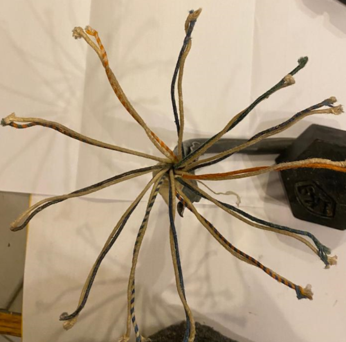

Yes, you seem to be essentially right, at least as far as structure is concerned. See piccie - 12 pairs, albeit each pair only 'just about twisted'. One of each pair is white, but no 25th 'thicker white'.
As for the use/purpose, I suppose that 'telephone' is by far the most likely answer, although I still suspect that it may have been essentially an 'internal phone network (during the war)', since the public network was then pretty sparse, probably not justifying multiple incoming 'lines' (the landline numbers of my great-grandfather's two nearby businesses were "10" and "49" in the 1930s :) )
... but why the thick lead sheath? I thought of 'rodents', but imagine they could nibble through lead without much trouble.
My continuing explorations under floorboards (and within some walls!) may eventually reveal some evidence/clues as to what these cables were originally connected to.

I assume your diagnosis is very close to the truth. The lead sheath was more common than I suspect you realise.
However I might have to complain you have fanned them out in the wrong colour code order. Any telephone engineer will be reeling in agony
I think you probably have to blame the person or machine who manufactured the cable for that. I made no attempt to 're-arrange' them - but simply 'folded them down in the order that they 'unwound from the cable ;)
