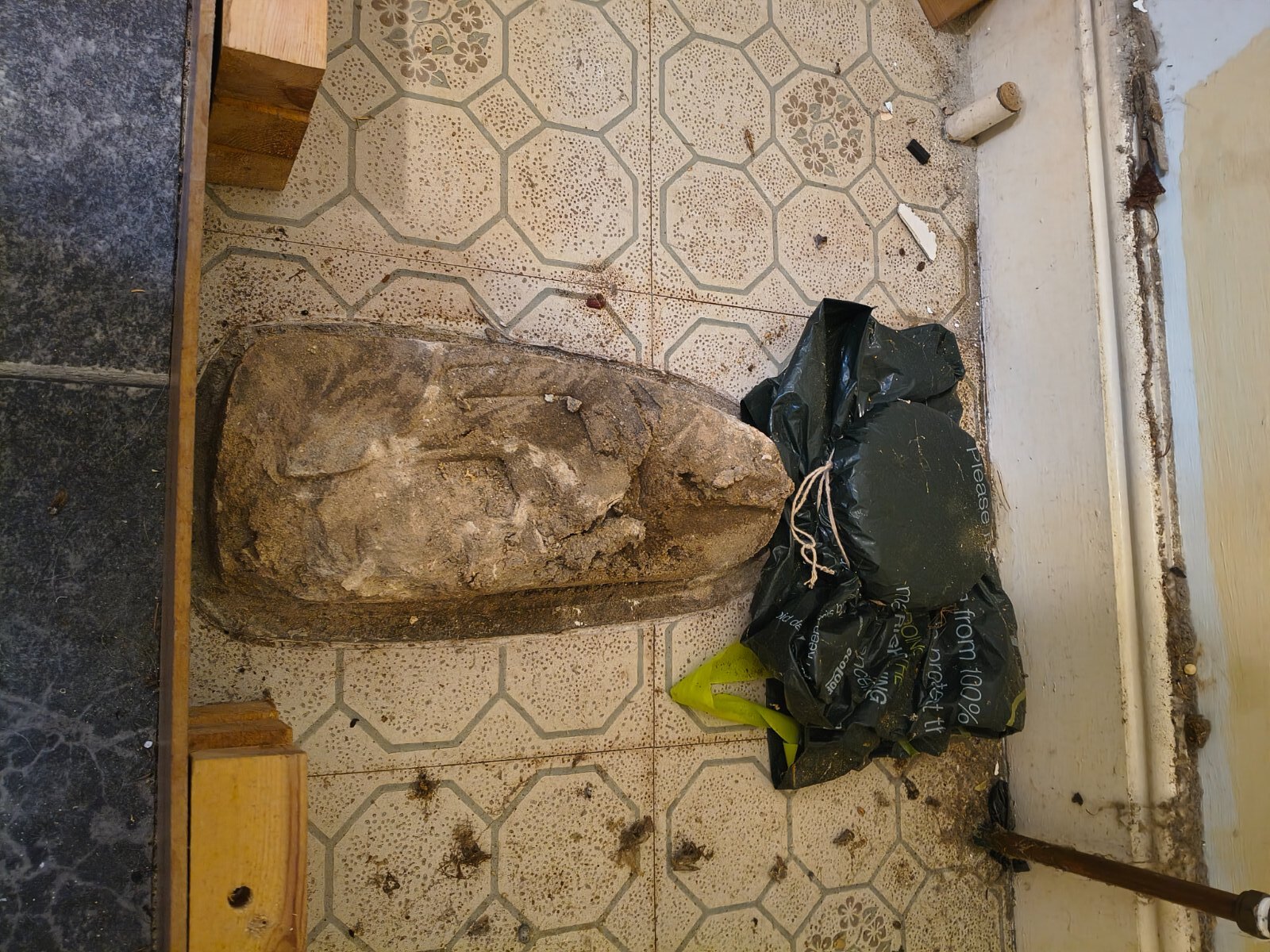

What on earth is that ?
1 Jul 2012
52
2
England
I've just removed a bit of false floor in what was previously a shower and loo and found this.
Obviously there a capped off waste pipe, but what's the concrete thing?
As above, it was once common to bed the loo on cement.
How have they sealed the old drain off? It really needs to be something more substantial than a plastic bad and some string, especially as you've opened it up to daylight, there is a risk Vermin may find a new entrance into your property!
What is the plan for the room?
I think that the outlet into the manhole has been blocked, but as I need a plumber to re-route pipes I will get them to check. I'm hoping that they can lower the outlet to floor level. I'll put a paving slab over it in the meantime.
It's going to have the washing machine over it eventually.
