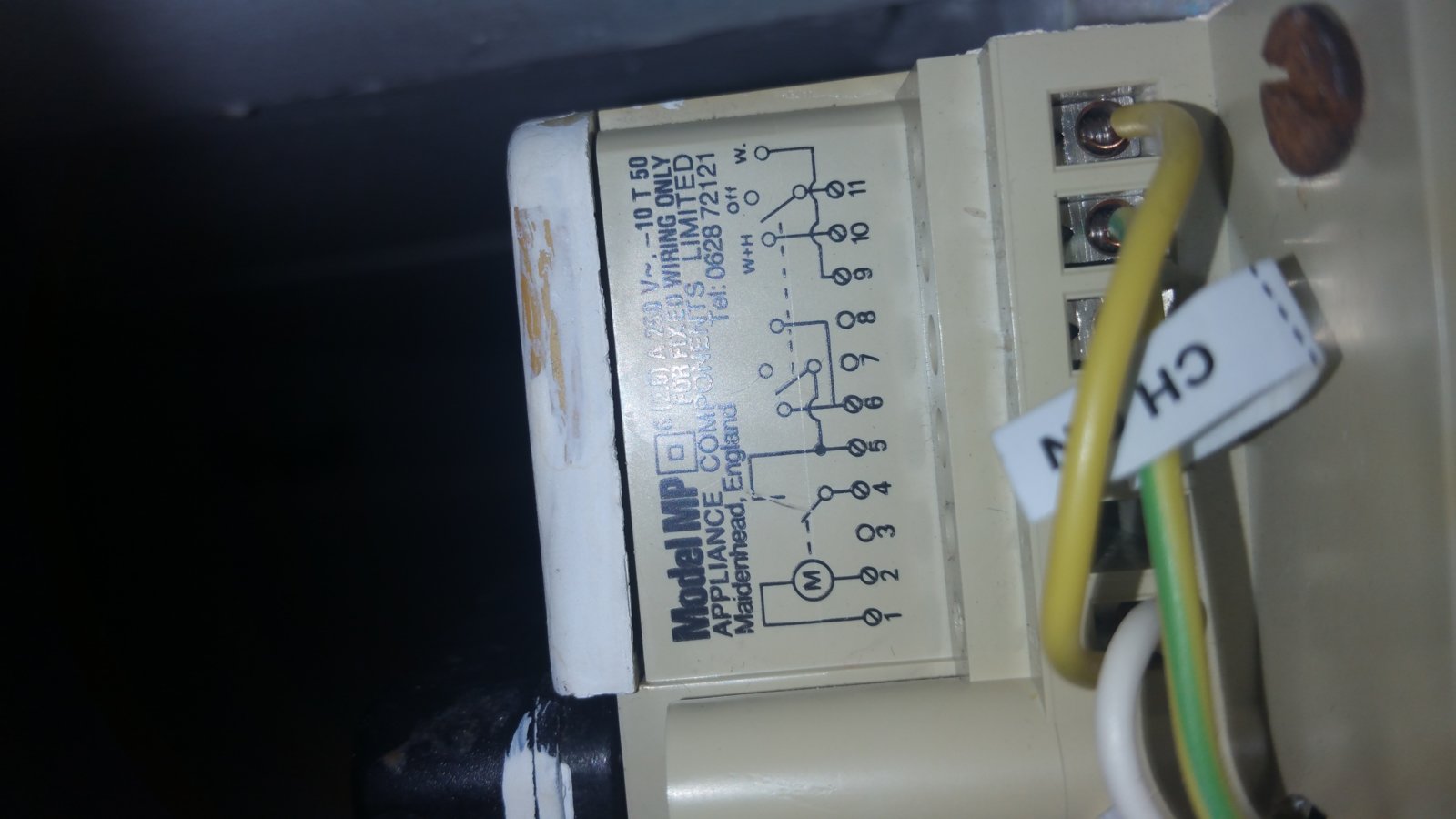

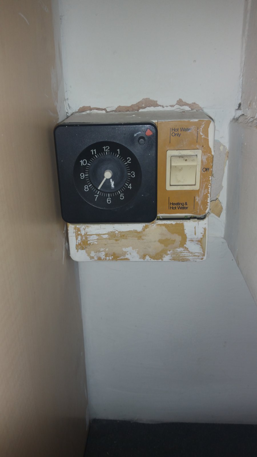

Hi there,
I am new to the forums but have completed some good DIY products with the help of this forum but I am well and truly stuck can anyone tell me what programmer this is?? I have searched everywhere and can't find it.
I am installing a Hive and need to make sure the wires match, if anyone recognises this and can offer help it would be much appreciated
I have attached some pictures that should help.

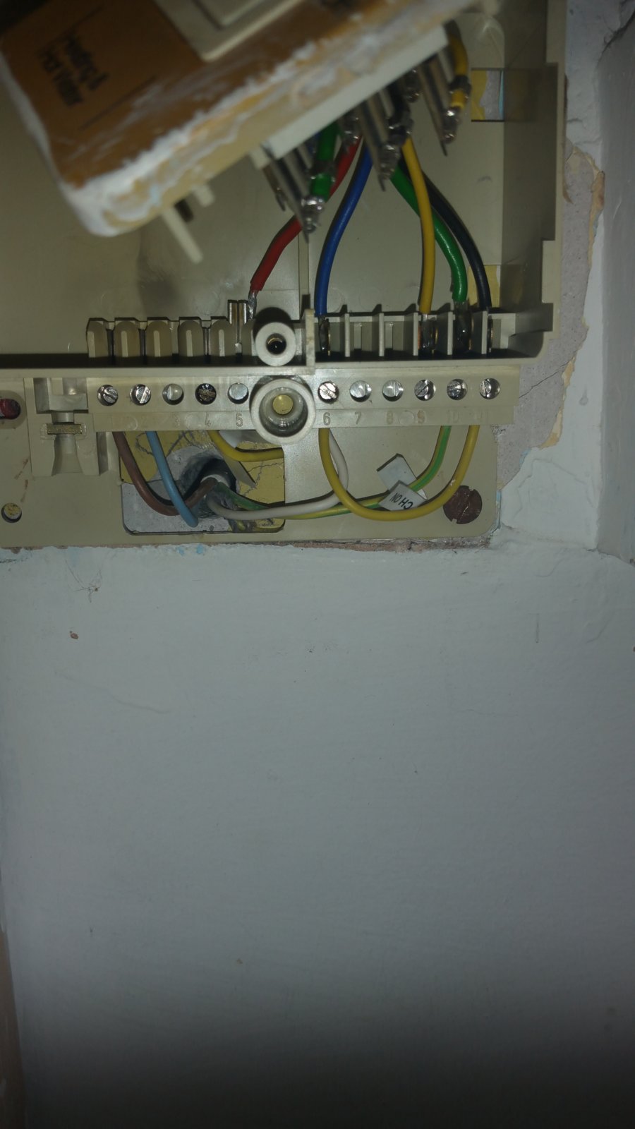

If the timer is still working it would be worthwhile trying to identify the wires with a multimeter.
If you aren’t confident with that, some pictures showing how that multi core cable is wired up at the boiler end would be useful.

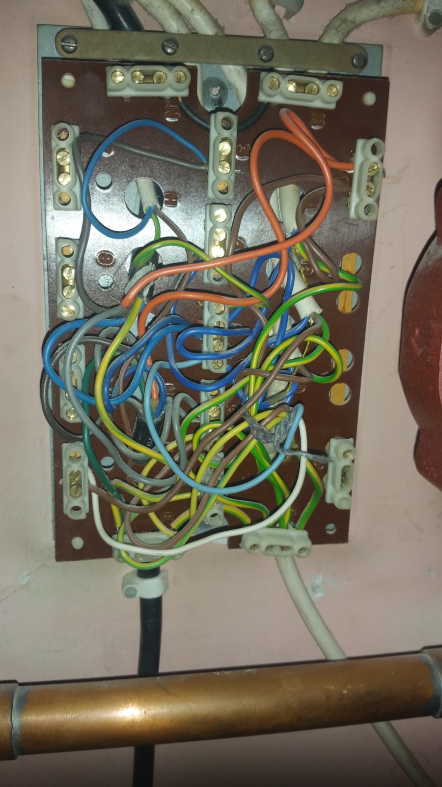

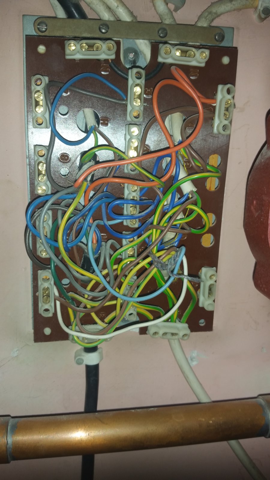

Hi Jackthom, no I haven't got a multi meter, do you need a picture at bolier or where the programmer wires go to the junction box?
Bottom right is wires from programmer (brown, yellow/green, light blue, white and yellow wires) wires above that are from the boiler (has blue, brown and yellow/green wires)
Is that what you need?

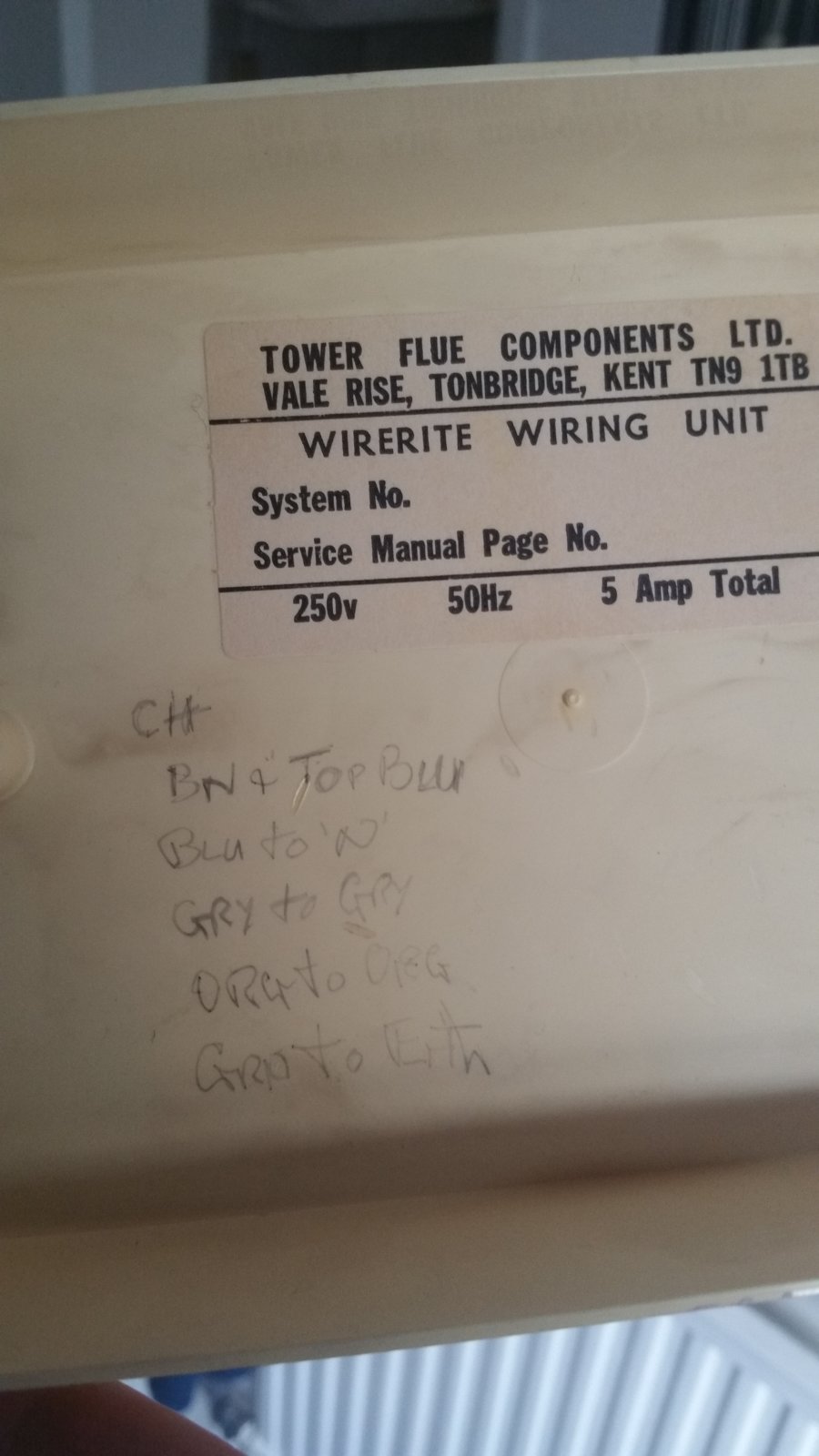

Updated, this picture is on the I side of the cover...

Haha, I agree I think it was designed for the caveman in mind.
Thanks for the advice, what is yellow into 4?
