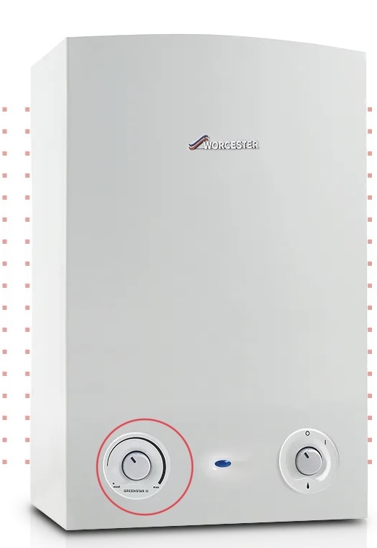

With heat only boilers, Ideal Logic and Worcester Bosch Ri series cannot be range rated. At least not from the control panel. I would guess a gas engineer could open the boiler and range rate that way.
Doesn’t the Worcester have an adjustment knob on the front panel?
My Vaillant heat only boiler is adjustable through the menu.
Yes. But that just adjusts the flow temperature.

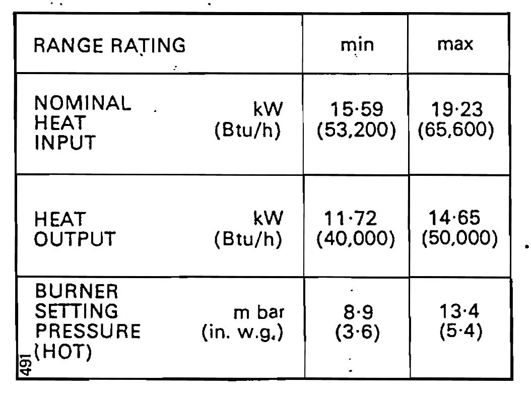

What's the rating of your existing boiler? 7.76kw sounds a bit sparse for your house.
It's a Glowworm Space Saver MKII - I believe it's Max output is 14.65KW looking at the Manual. And Max input 19KW

18Kw. That should do. We have a 3 bed semi with 10 rads and an 18Kw boiler. I have set it to 15Kw max output and it’s been fine but it’s good to know I have some reserve if it got really cold or added an extra room. Remember, you can always set the max output lower but if it’s too small, you can’t set it higher.
