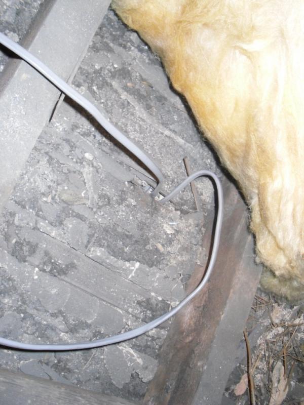

3. Below picture is of two cables going to/from the existing light.

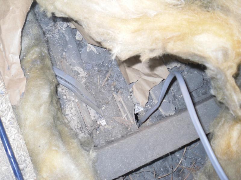

4. Below are cables going to and from the existing light switch. The cable on the right is going to/from the light fitting. The cable on the top left is slightly thicker than the other 2.

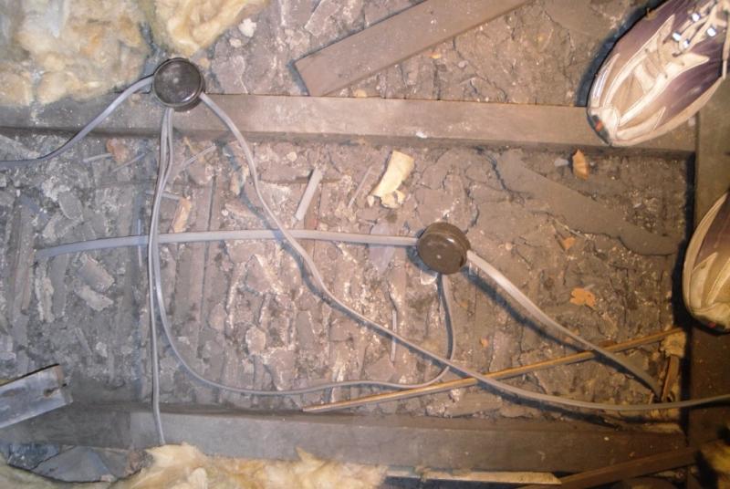

5. Just in case it is any help, below is the wiring on the other side of the attic (which also feeds a room with two switches for 1 light).

Your first picture either shows a feed and switch drop going to a light fitting or, if there are/were two fittings that came on together from the same switch, one may be a switched feed in and the other a switched feed out to another light.
The second picture presumably shows a 3C+E cable and two Twin+E switch drops to a two gang switch plate.
It looks as if you have typical loop in/out at the ceiling rose wiring. The third picture could show anything, personally I'd call it a mess!
Photos of the actual wiring behind the ceiling roses and switches would be more useful.
