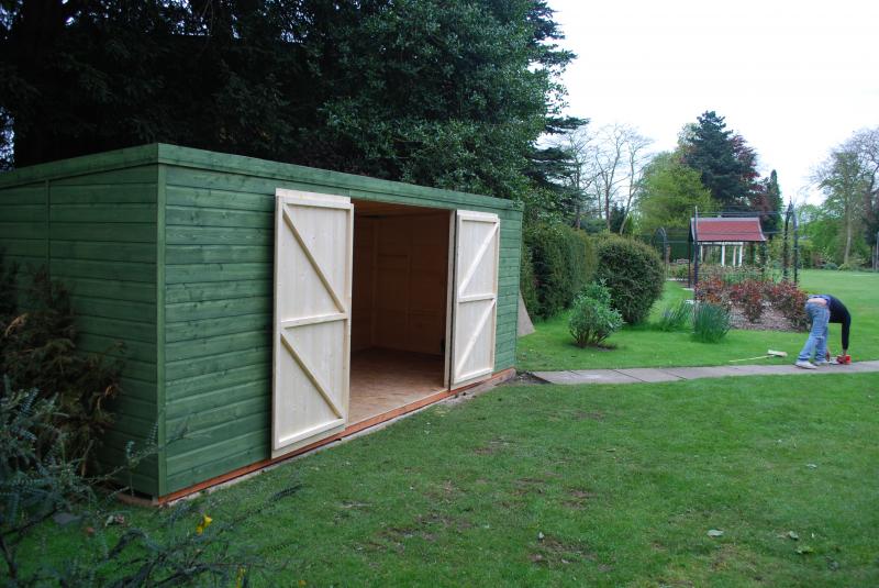

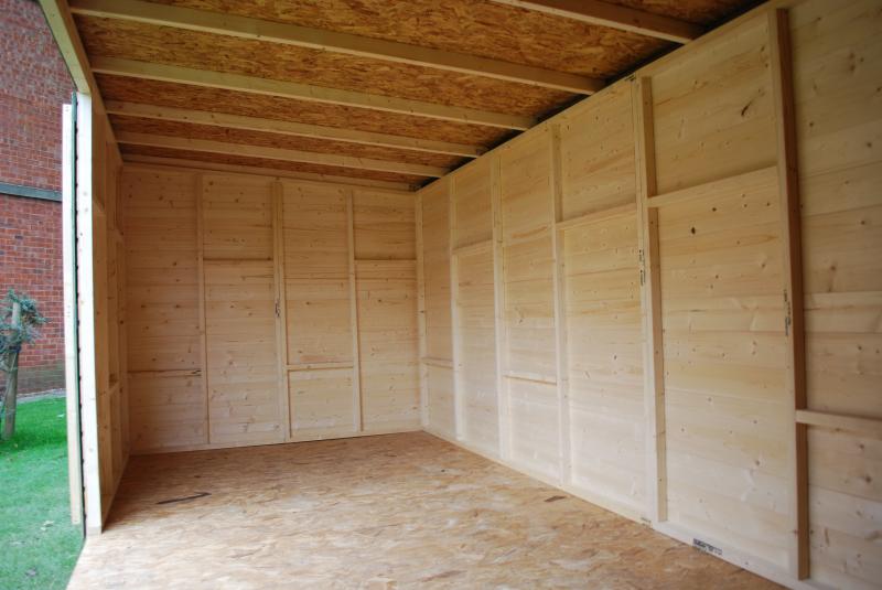

I have built lots of stuff out of T&G shiplap and as long as you treat it and treat it when it looks like it needs doing again say every 2 - 3 years then it will last more that 10 years.
When I say timber frame I mean the frame you build 1st normally out of 2x2 PSE timber or if you would like it more heavy duty then use 3x2. You can treat them if you like but they wont be exposed to the elements.
This is the stuff I used to build and might give you a idea what im saying.
Thanks for that - I see what you're referring to when talking about the frame. Nice construction by the way!
