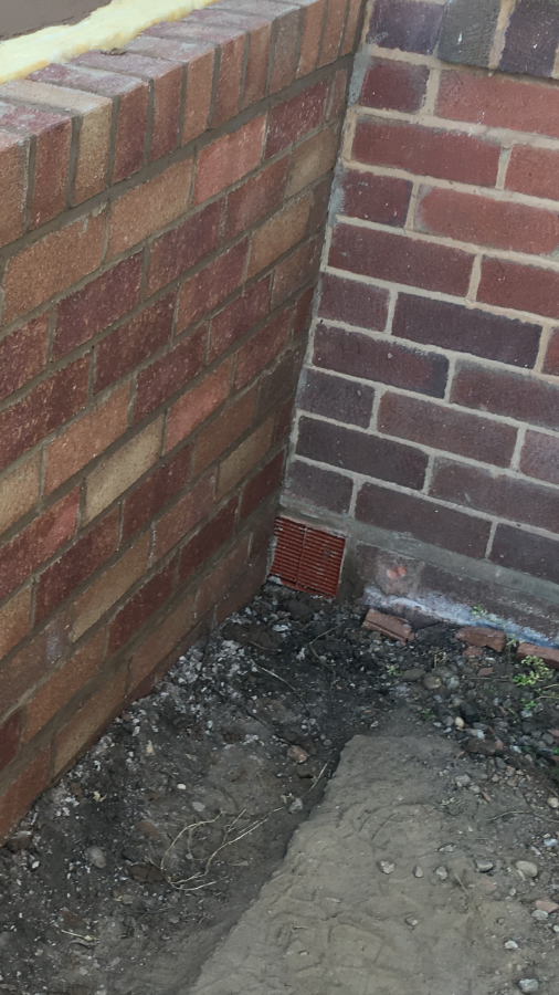

What to do about this vent
Oh dear things are getting complicated.
That clay vent only provides about 50% surface area ventilation due to the thick pieces of clay between the holes.
So, you tend to find that a modern plastic air brick of half the size is equivalent in actual air space.
Or knock it out and cover the top half of the gap with a fine mesh (aluminium plaster patch is the right size and saves buying a whole roll of ss mesh). You just need to fashion a support frame, or mould the mesh corners into the gap and silicone around it. Then a coat of paint if you like.
Keep it simple.

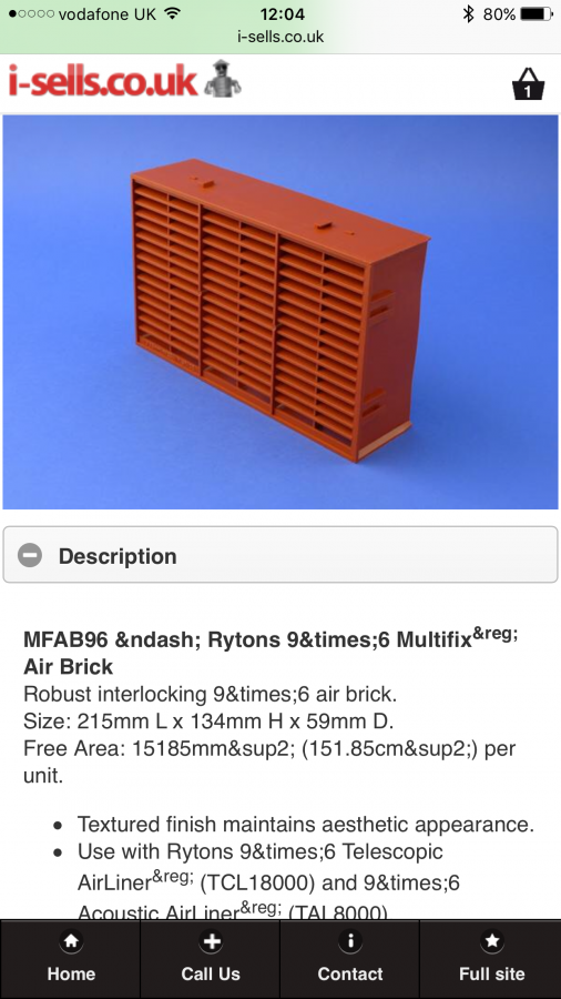

Ok. I will go with the plastic air brick option.
I will buy a 9x6 one. Will the one in picture suffice?
Also what's the easiest way to remove the air brick?

You will need your home serve insurance for £1 per month.
Nice drain for the rain water to go into when it rains hard.
