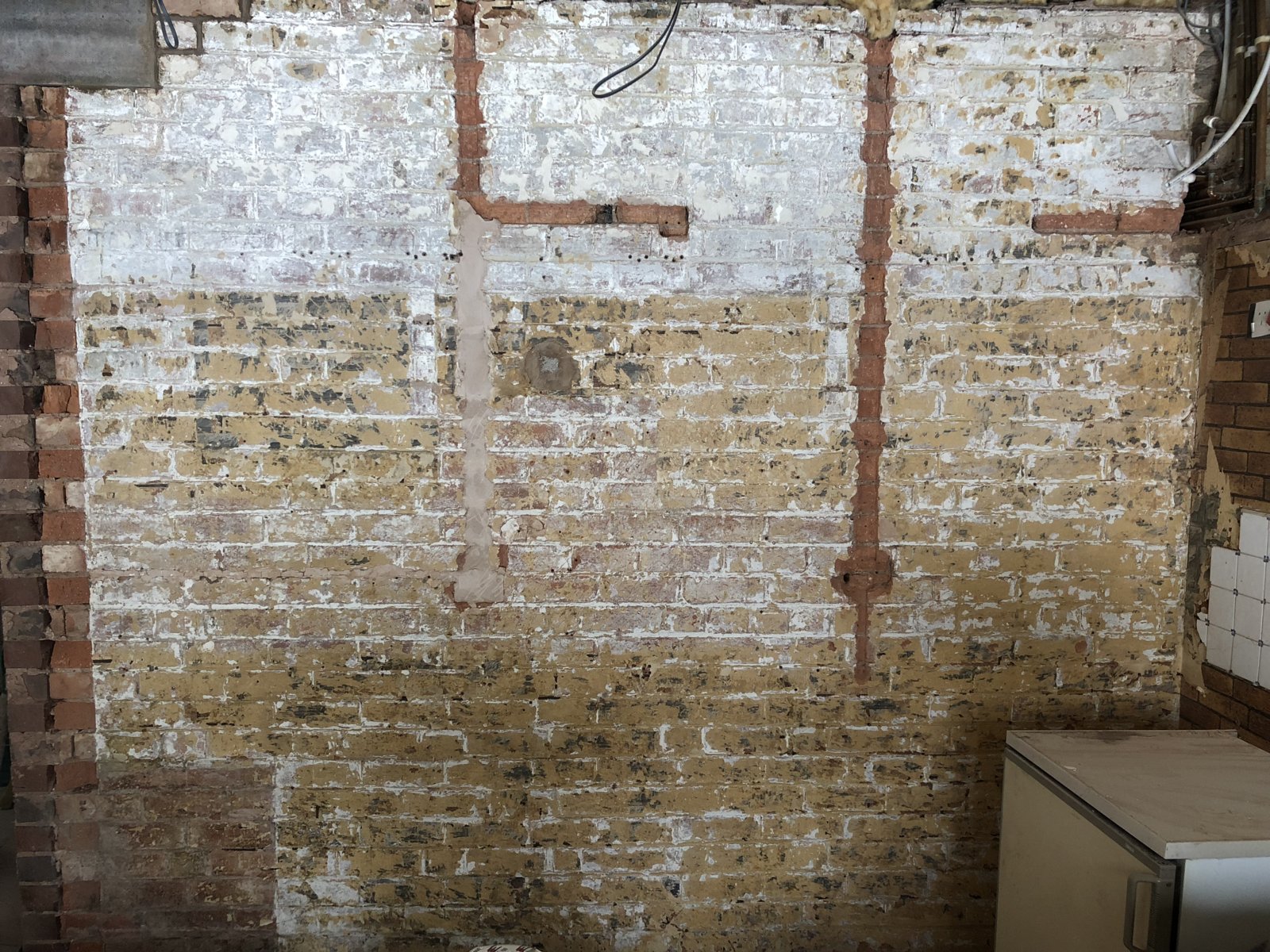

Got a whole mix of walls to attach my plasterboard to. I’d like some advice on my thoughts
Stud walls - screw (that was easy!)
Medium density concrete block. No prep, just dot and dab.... or should I wet down first?
Now the problem walls. Original 20’s common bricks, painted several times, papered several times then tiled on top. I’ve busted my balls today removing as much as I can, but looking back at my work it’s depressing. Basically a mix of brick, paint and bits of ripped backing paper dotted about. What to do? Spend another day scraping around? Is there something magic I can paint over the walls to stabilise this crap? PVA? Ideas appreciated.

Brick even if old and dusty - fine
Paint - probably ok unless coming off
Paper - definitely not
Without seeing it hard to say whether it’s worth taking the risk of dabbing it
If the plaster is old and crumbly it needs to come off and a wide chisel in an sds drill will do that.
If it's sound, board foam adhesive will be best. And this will leave you with more of the room left than dabbing or battens.
Plaster? You have to be joking! None of that luxury. In fact the whole thing is quite comical. Original bare brick, painted white, then green gloss, then wallpapered with grey brick wallpaper, they liked brick so much they then did coloured brick wallpaper, then anaglypta paper painted. Here is my “finished wall” after another few hours this morning.
Ps. No pipes wires or services on this wall

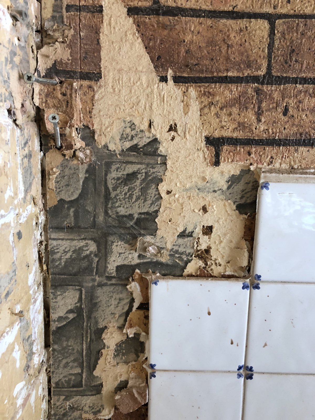

And just for giggles, if you had brick walls, at what point would you consider banging brick wallpaper on top? Twice? Grey underneath, then brick colour....

If the paint or whatever is well stuck, then it can be just boarded over.
You could if you like, use something like Zinsser Gardz to seal it
it looks pretty good to be fair, I'm not sure why you'd want to change it
So if the walls have had the loose stuff removed, would a lash of diluted PVA be of any benefit?
Agree, I've been in new shops that specifically put up cladding inside to get that look!
