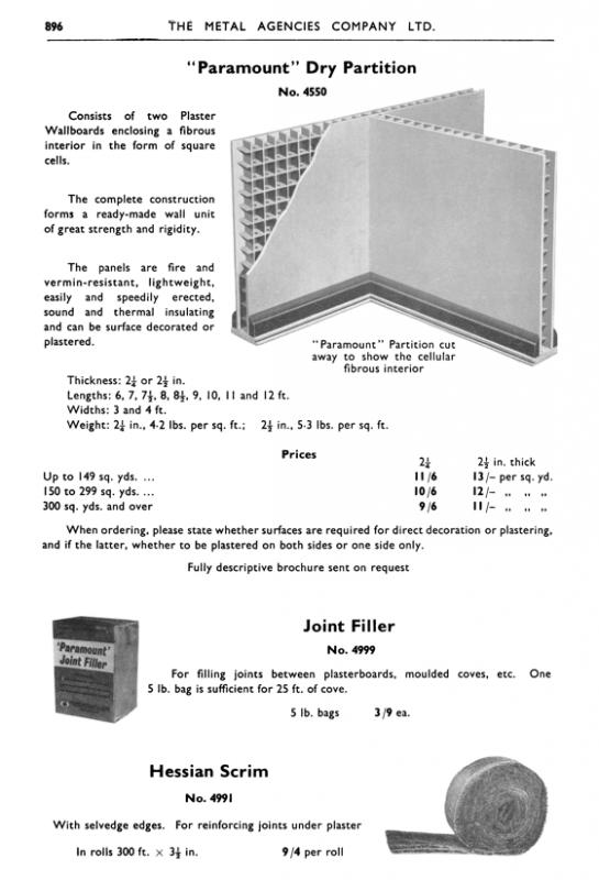

Education time, it seems ... wot's a 'paramount wall' ?
Kind Regards, John
Paramount boards are two plasterboards that have an internal sandwich of corrugated (honeycomb) cardboard. Used quite a lot in the eighties but not now.
Joiners used to fit head and sole plate timbers and you could slide them over them and if you needed any timbers for fixing items, could hammer the timbers in to corrugated section.

Still used in some office partitions using aluminium base and head rails, and "H" section verticals between the 8*4 sheets - It comes ready to be painted/papered, or already papered with huge 8*4 paper (the paper is available seperately too and is a PITA to hang!)
Fitting dado trunking to it is a pain for fixings (have to use cavity types) and you have to nibble around the risers as they protrude from the walls.
Paramount walling.
I had that in my old home, great for adding sockets, as you just cut away the plasterboard in the desired socket location, and dropped the cable down the pre formed vertical grooves, via the ceiling void, insert a dryliner box, and on goes the socket. :lol: :lol: :lol:
