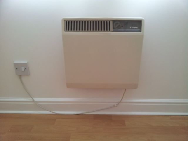

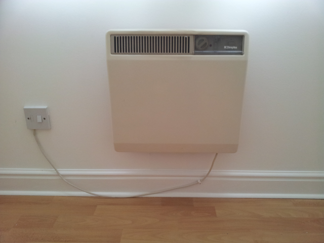

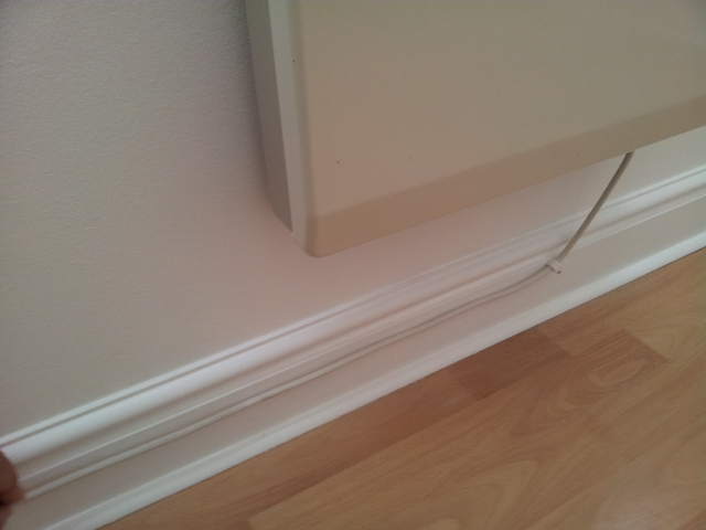

I have a rather silly looking slack cable I can't work out how to deal with. Clipping it to the skirting board still doesn't look right. What's the pro solution?
You either need more slack (so it drops vertically to and from the skirting) or cable tie it to the mounting brackets so you have a horizontal run from the fcu to behind the heater. Even better would be move the heater to the left or move the fcu so it's under the heater (prob not worth the effort of that one tbh)
The cable was longer and I did cut it. Obviously that's a mistake. So, I need it to go vertically down and up. I imagine it will run side ways immediately above the skirting board, and the clip nail will go in at 45 degrees into the round bit of the board? If the cable is too short now, I can change to a new one.
It's really an aesthetics thing exactly how you do it- safety wise not kinked, not stretched and not a trip hazard are the objectives.
Move socket or move heater.
If plasterboard feed cable behind board.
Problem is socket it too far away from heater
safety wise not kinked.
How can you turn 90 degrees on the cable without kink?

Moving socket would require notification and electrician. If I am as heavily loaded in the wallet as most people here are, I wouldn't be here. I would be busy hiring an army of workers. Actually, I did do that and the funny looking slack was caused by them. It wasn't this funny looking before they touched it.
The heater is centrally aligned with a window above. Moving that would make it look in the wrong position.

It might work. I can't handle complexity and bulk. To me the trunking itself will stick out visually.
You turn it with a gentle bend which is within the minimum bending radius of the cable that you are using. This might require you to use a larger piece of trunking to accommodate the bend.
Looks to me that there "just" might be enough cable to drop vertically from heater and fcu if the cable ran along the top of the skirting

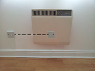

I would bury a cable in the wall from the FCU to a hidden flex outlet behind the heater, and possibly move the heater across to the left slightly so that it's slightly closer to the FCU (window symetry allowing :)) That way you aren't moving the FCU, and only making a connection to its load terminals, as you would if you just changed the heater for another one.

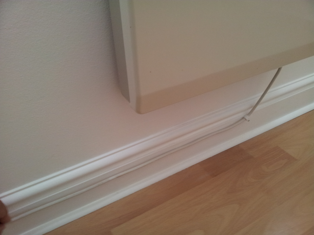

It would look considerably better if you clipped it to the very top of skirting board, with the clips at say 7" intervals, with any cables kinks smoothed out.
You may like to consider some white D-line trunking just above the skirting board - which will blend in with the skirting board very nicely.

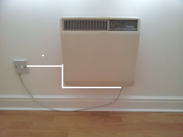

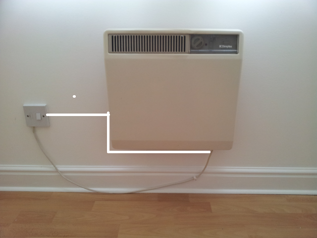

I would use trunking and make it as below, nice and neat and more importantly safe:
Why do you need the trunking down the side and along the bottom of the radiator?
Just have it running in behind the radiator for a short distance
