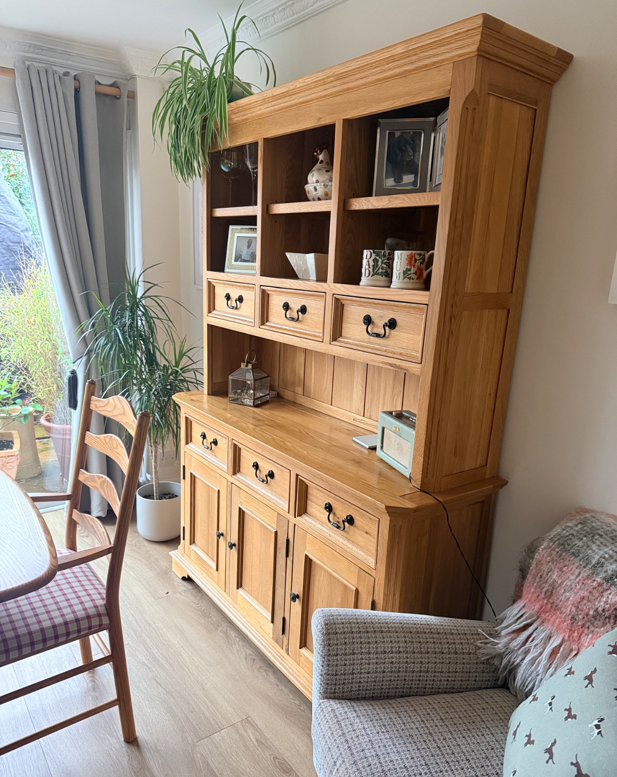

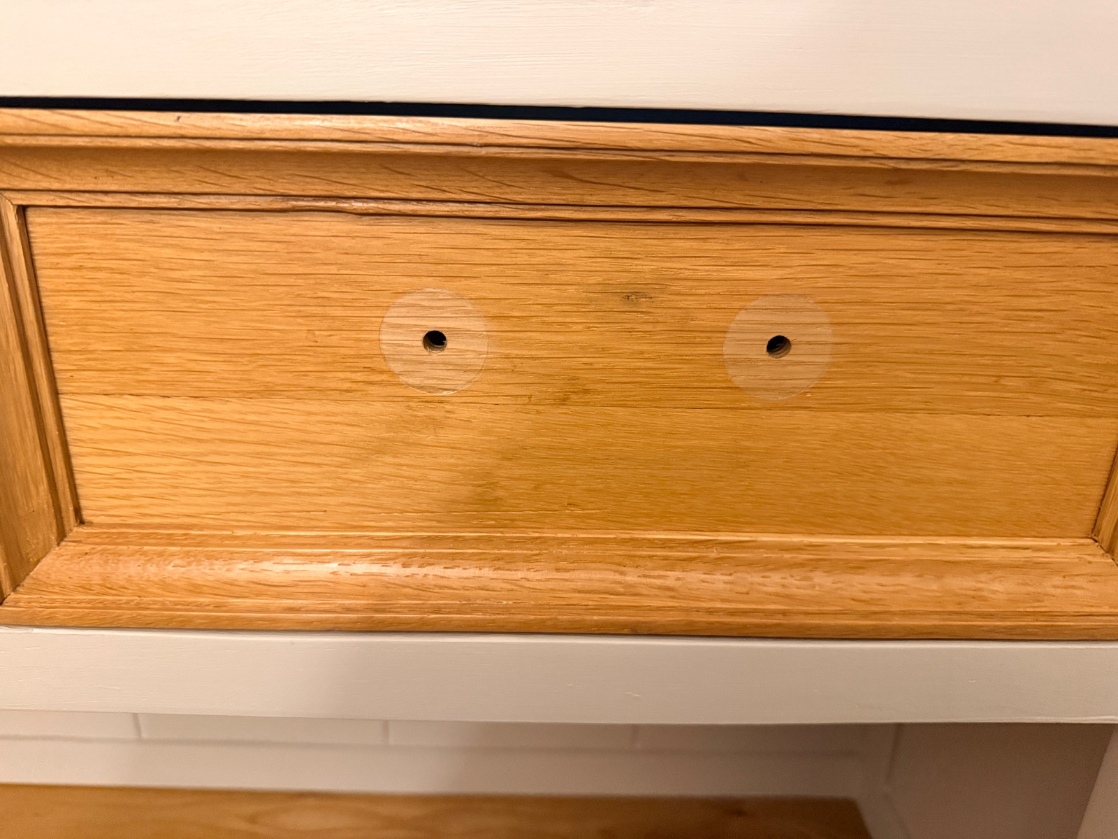

I’m having a go at 'upcycling' our kitchen dresser - just painting it and changing the handles but the handles I want to use on the drawer fronts have the spacing for the screws differently - 64mm instead of 100mm. I plan to fill the holes, paint the drawers and drill new holes to fit the new handles but what’s best to use to fill the holes with - ordinary polyfilla, wood filler or something else?
Edit: What about if I got some wooden dowels, banged them in (using wood glue) and sanded them down before painting? Would that work?

Id go with wooden dowels.
Undercoat then ready mixed fine filler if you want a great finish on your project.
Other way is 2 pack wood filler, but be neat and tidy when you use. Don't spread it around..
2 pack is resin and harder in a can...
Possibly the best you can do is make a bit off a feature, as they won't readily disappear end grain will take stain very differently and oak and beech have different colours and grains
what you can do is cut a plug from the inside surface off the drawer or hidden area to match up but needs a plug cutter the right size and wood with a matching grain

Not worried about end grain as the drawer fronts are being painted. Looks like wood plug, fine filler and paint it is then.

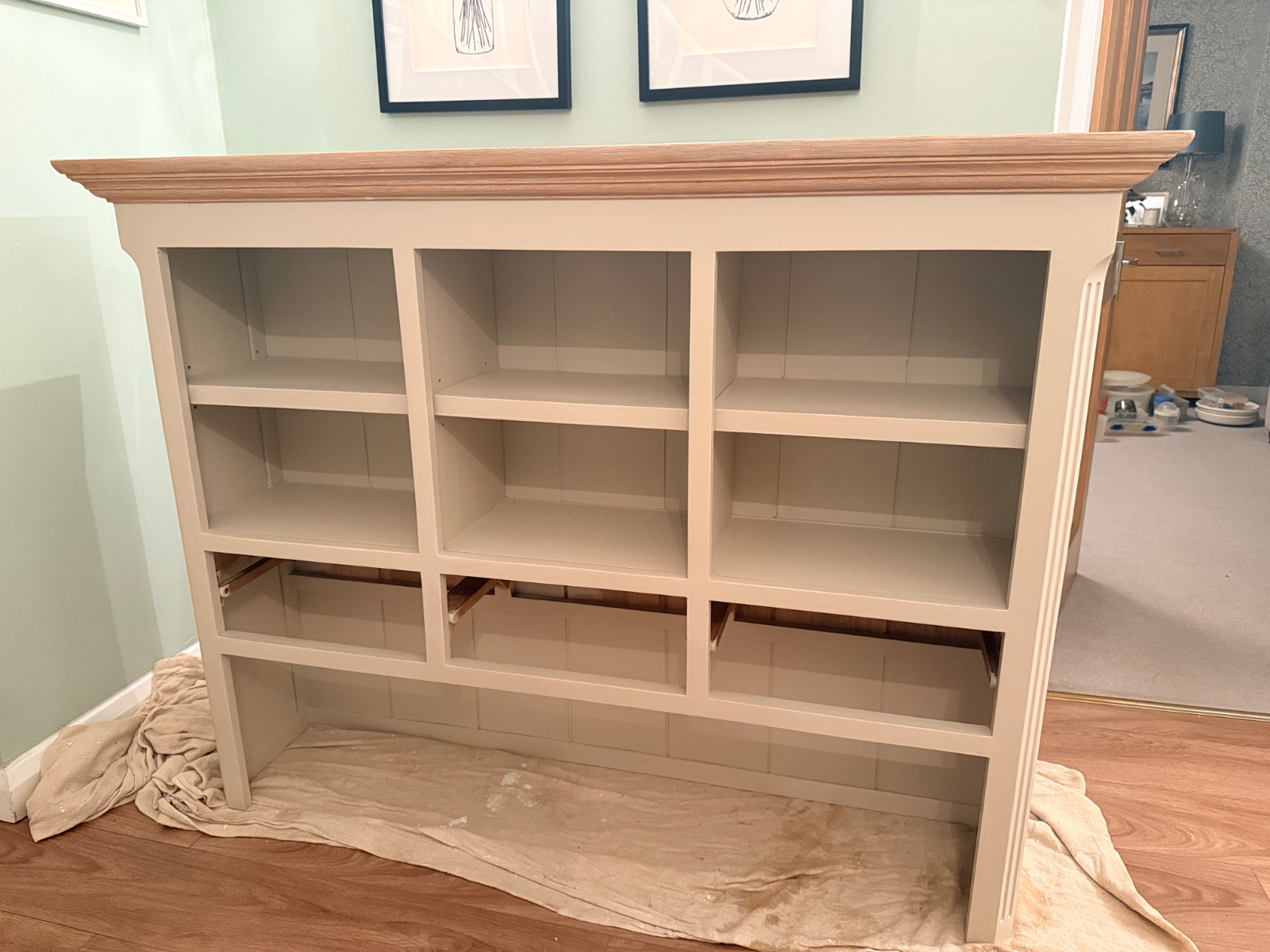

Yeah, that’s what I'm doing. The whole thing is oak and I’m painting it but just rubbing down and waxing the top edge of the top unit and the whole top of the bottom unit plus changing the handles and knobs.
Pretty pleased with myself. Glued a wooden dowel in each hole and cut it off flush with my multi tool, sanded it down, painted it and you’d never know they were there.
I would give it 6 months of temperature and humidity changes before declaring victory :)
Why? I can understand it if I filled the hole in wood with a different material but I’ve filled a hole in wood, firmly, with wood. Will the dowel expand and contract at different rates to the wood of the drawer front? ?
