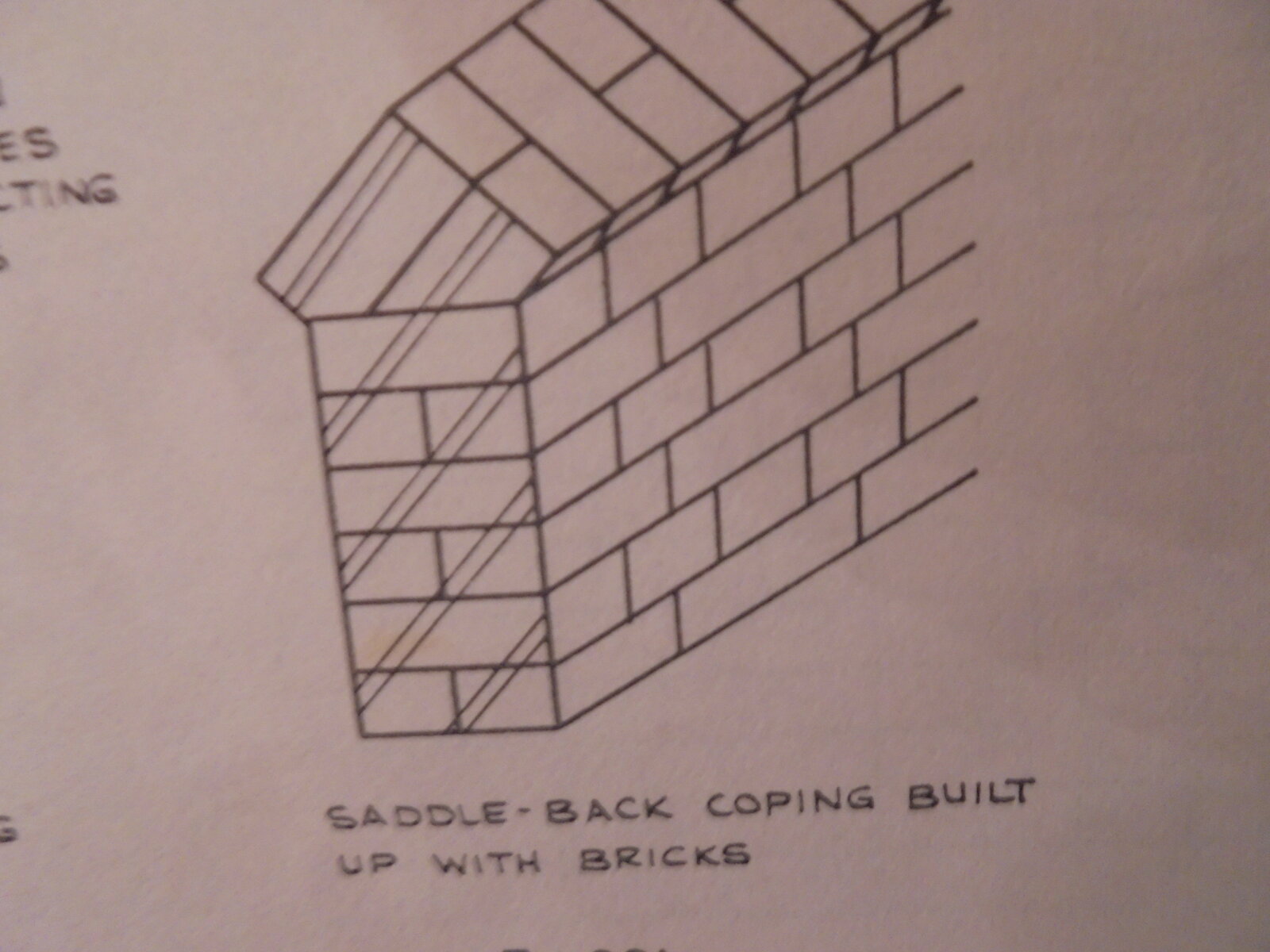

I am about to have a new retaining wall built that is going to be approx 20m long and it will be stepped down a bit in the middle section. The highest point on either end of the wall will be 900mm high and the lowest point towards the middle will be 700mm high.
The wall is going to be made of concrete blocks with the front facing part of the wall rendered. There will be proper drainage installed on the backside of the wall.
Can anyone recommend what would be best to lay and look good on the top of the wall? We were thinking that whatever gets laid on the top, it would be wider than the blocks so that we could run some LED strip lighting beneath the top section. We will be having a new porcelain tiled patio layed.
Wide coping stones with a small ridge along the centre?
Make sure there are drip grooves under each side so any top water won't run under the stone then run down/soak in to the wall.

The problem with rendered walls is that traditional copings are designed to project from a bare wall, and once you render you need to be careful that the overhang and drip is maintained.
How thick is the wall?

Thanks. The thickness of the wall (concrete blocks) will be approx 200mm and then to allow a few millimetres for the rendering on the face of the wall.
Is there anything particular I should consider in terms of the rendering of the wall? Should it contain some particular mixture to add strength and/or durability?

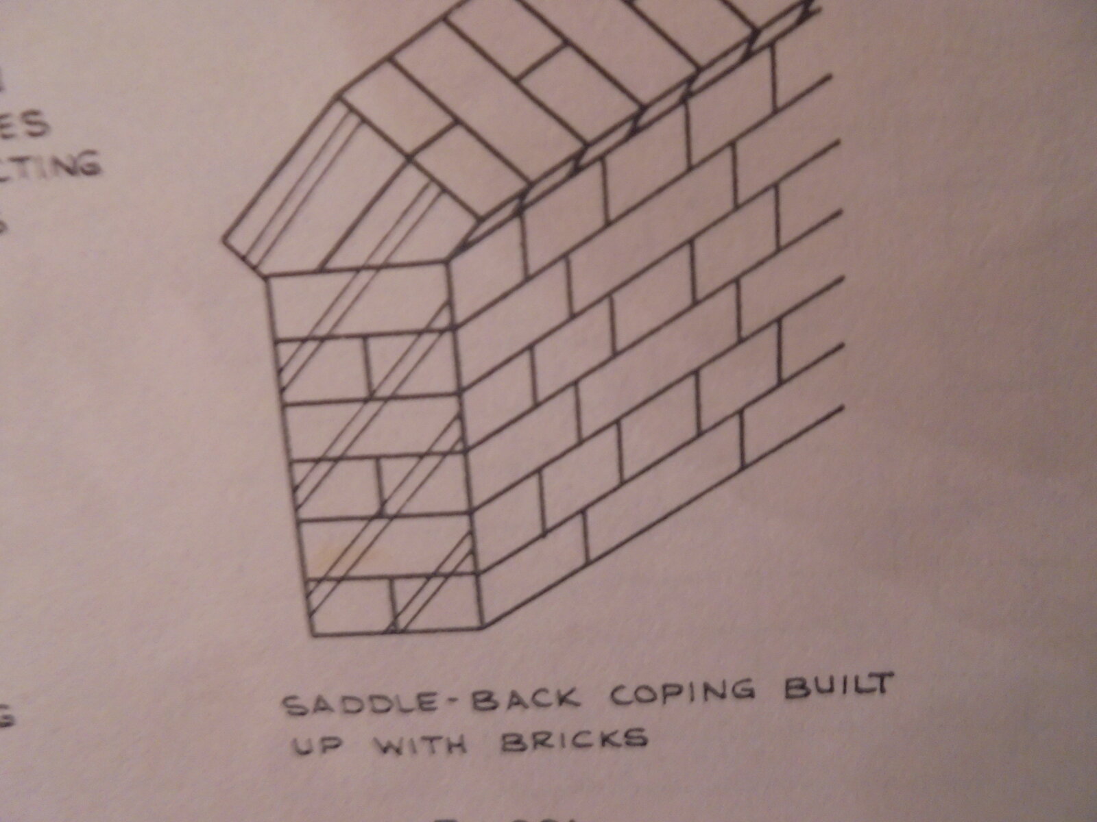

You could do it like this.
