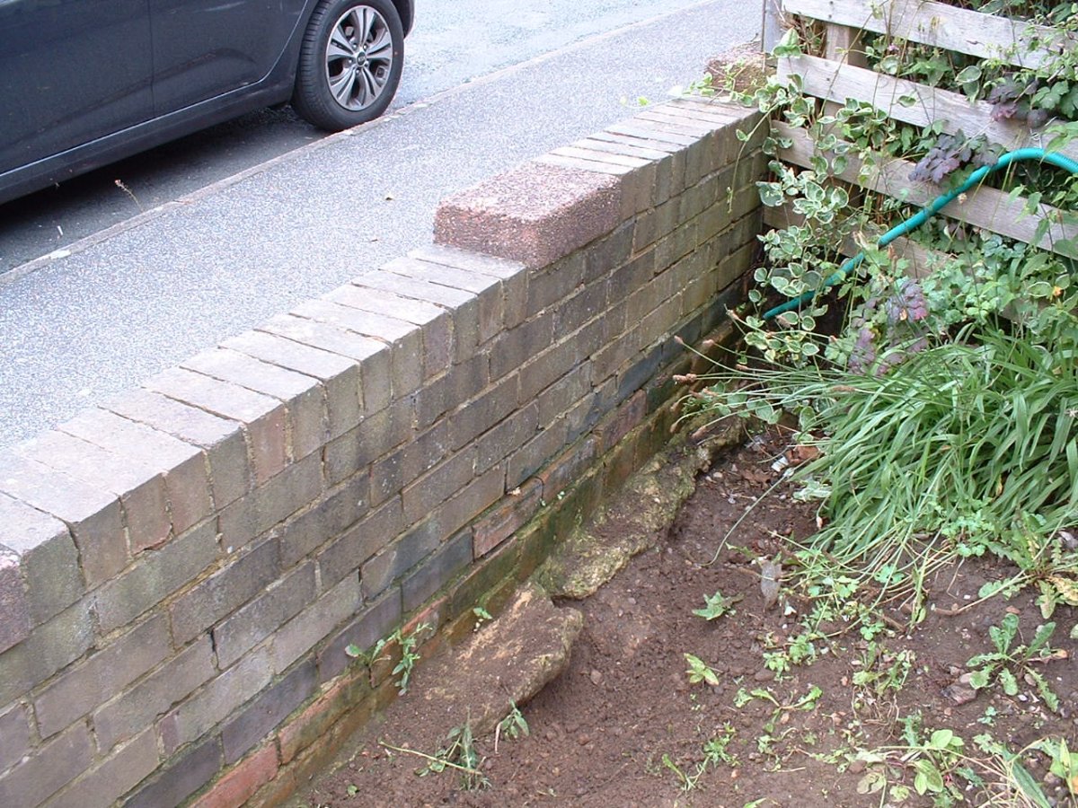

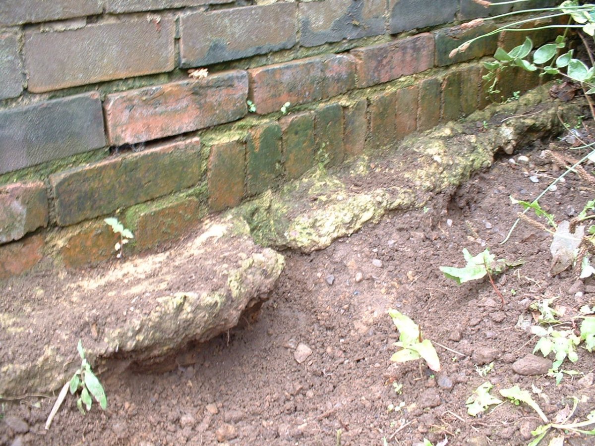

Here are two pictures. A general view of the wall (which is 70cm high). And a picture detailing the foundation. I've just messed with a small section, as an exploratory investigation. Really, I'm just wanting to tidy up the foundation on my side. Of course, I don't want to end up weakening the foundation so it begins to slowly keel over into my garden.

It appears you have removed soil since the foundation was poured. Simply add some soil against the wall.
I'd knock the overhangs off with a bolster and trowel some concrete up against what's left. Then bury it.
What I'm minded to do, is remove the "over-hang" for half the distance of the length of the wall, that would be 3.6m. If the foundation is 6" thick just below the wall, then I would see the wall sitting on that 6" of foundation. In that 3.6m section, I'm minded to remove dirt to a depth of the current foundation out to a distance of 6" from the wall surface. Of course I'd put shuttering parallel to the wall and 6" from the wall. Then I'd fill in the 6" x 6" x 3.6m trench with concrete. Of course, that section has wall either side of it. It won't be a situation where any section terminates in and end of wall. So, there will be support on either end of the section. Now, safety is an issue of course. On that score I would think that this rather small wall would not budge at all during the time the trench is unfilled. And won't move after the concrete sets. Precisely because the wall is presenting no significant forces. It may be wise, to support the wall from halfway along the section, however, as I say, I'd not think the wall is going to move for the time the trench is unfilled, which could be say an hour or so. I welcome any comment on the safety issue and the long term stability of the wall after the proposed intervention. Thanks. Wall is over 50 years old. Rich
I suspect if you dug down a bit further, you'd find the foundation under the wall to be oaky, so shouldn't need supporting whilst you work. All you're doing is tidying up the footings, so as you say, you just need to go down about 6". On that basis, you just need strips of shuttering 8" wide, and for what you're doing, even 9mm thick and backfilled behind it would be fine, but if you want to do this on the cheap, maybe look for a couple of 15mm melamine faced boards like these, and do it in 2.4m sections instead.
