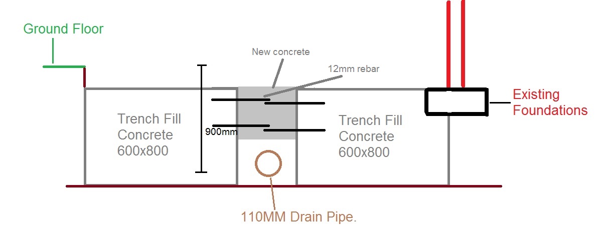

Hi guys hoping if someone can shed some light on a problem I have.
Currently have an extension being built.

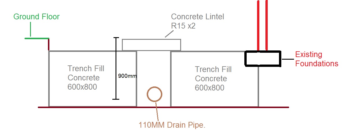

The foundations have been poured but I'm getting paranoid about how the concrete was shuttered off to solve the problem of drainage running through foundations. The plan is shuttering the concrete and using 2 concrete lintels on top to bridge over.
The drainage is currently at a depth 900mm from ground level. Foundations have been dug to below invert level of said pipe. With a gap of 150MM+ either side of the 110mm drainage.
Whats worrying me is how it's been done means theres two seperate sections of foundation (see picture attached - sorry those are my best paint skills).
1. Would this method cause differential movement between the two sections?
and/or
2. Is how its been done an accepted and valid method?
Thanks for any advice guys, been getting worried about this!
Rob.

It's not right. The pipe should have been bridged as close to the pipe as possible , allowing a gap for settlement , so about 50-100mm above the pipe.
It will likely pass building control inspection, but what you have now is increased risk of differential initial settlement, and differential movement longer term.

Not sure how it would have passed B Regs, I certainly wouldn't of. The foundation should have been stepped under the pipe.

My Bco wont sign off unless the foundation runs under the pipe is built up to and linteled over.

At this point, is there anything I can do to fix this problem?
Can rebar be drilled into either side of foundation fixed chemically and a new pour of concrete to join them together?

As you have some deep foundations then I would probably accept that as long as the rebar is continuous over the opening so either overlap the bars from either face to be drilled or wire another bar to the ends fixed into the founds.

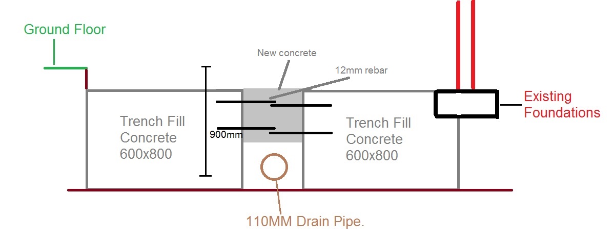

I'd probably go for 4no 12mm+ bars.
So to clarify is this how you would go about it now?
doesn't there need to be a bridge of concrete underneath the pipe to?
Excuse the paint drawings:
Thanks for the reply. There isn't a requirement for concrete to run underneath? and it's fine for the hole to be square around drain?
