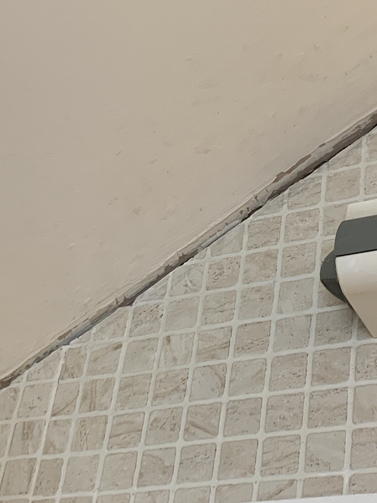

I have removed old cracked grout from the join between the ceiling and tiles (see photo) what should I use to refill the gap?
If you want you can use grout again, but always a chance it will crack.
Good quality adhesive like mapei mapesil is ideal.
If you need it to be painted then consider a copolymer mastic that's paintable like ebt+
If it's quite deep you might need a backing rod or similar.
