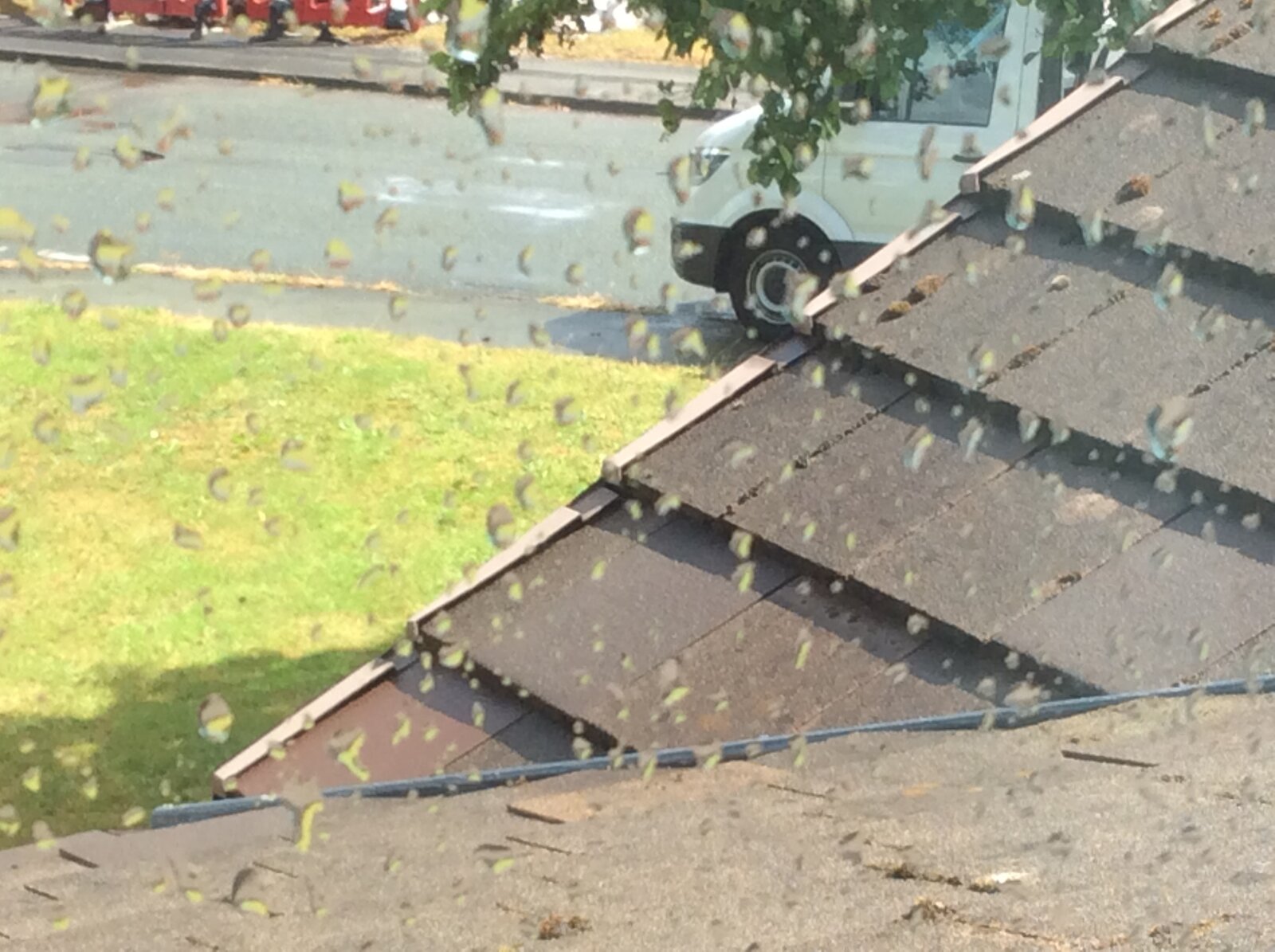

What type is are these dry verge
6 Jun 2020
2
Anyone any idea what these are fitted to a mates property a couple of years ago
some how or other they are still hanging on
Don’t look right to me !
Need taking off and replacing with ?
Would appreciate any suggestions.
They are segmental dry verges.
Your options are replace like for like.
Install a wet verge with under cloak or continuous dry verge strip.
Plenty tutorial on u tube for all 3 systems.
Thanks for the suggestion but
they just don’t look right the step on the top is not allowing the plastic to sit on the tile properly.
looked at some videos and the plastic seems to be sat fully on the tile.
It’s as if these were designed for a smaller tile ? so the step would sit down the top edge of the tile
