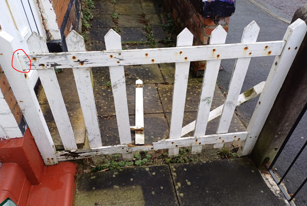

Hello,
I am going to try and replace this fence.
Does anyone know the name of this joint?
I will try and do exactly the same one myself!
It's a fairly crude mortise and tenon - where the upright has the mortise, and the horizontal rail forms the tenon.
That one seems to be pegged or doweled in place.
John :)

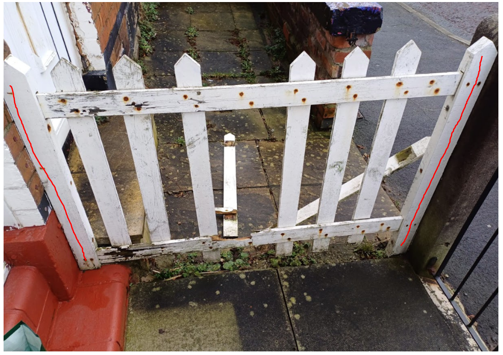

The two end pieces don't look too bad so you could reuse to keep the mortices
drill a row of holes then finish with a sharp chisel
unless you have a 1/2" router in which do it with that -if you do, I would suggest leaving the stiles well overlength for the fence to run along

Looks like a pinned mortice.
Strictly, there is no tenon as the stile is just slotted in. Two dowels are the pins to secure the two pieces. Alternatively the stile can be run through to the other side, and wedged instead of using [visible] dowel pins.

Ok, so the slotted hole is called a mortice
the way to make it with minimal tools is to mark it out on the stile (vertical part), then drill a row of holes using a drill bit, then square out the hole with a chisel
Since the rails (horizontal part) are the same size as the mortice, they dont need any work done to them

Except to replace them with new ones. You could get away with replacing just the bottom one if money is a bit tight.
When you re-fit this, do yourself a favour and mount it slightly higher up so the bottom of the left piece doesn't sit in water.
If you're planning to re-paint it [if you care about longevity, you will] take it indoors to dry out for a bit before doing so.
I am thinking I will cut the mortises with a chisel then.
