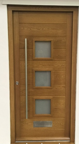

I need to identify what type of lock is needed to achieve this situation.
A modern door with a fashionable long pull handle externally and no lever - just a euro cylinder.
But inside there is a lever!
I can't work out what type of mortice lock it is - as from the outside it suggests just a mortice deadlock and key operated, but on the inside it suggests a mortice sash lock and lever operated!
Outside
Inside
look at the edge of the door. is there a brandname on the fore-end of the lock?
Lol, no I got the photos off the net just to illustrate the situation.
It seems to be a very common thing with contemporary doors, but I can't work out how it works with just a key operated from the outside.
it'll be a deadlocking nightlatch mechanism I expect
there used to be a few lever locks like that, I only know one still marketed, the 3R35. There were some cheaper ones, Union and Wellington did them.
High street banks that still have wooden front doors use that kind of thing.
yes, just goggle "mortice nightlatch"
there seem to be quite a few.

Also look at "escape locks"
No quite the same thing but can be opened from inside with a knob or handle, but need a key from outside.
