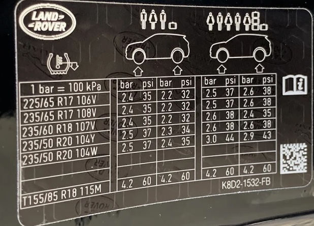

Look on the tyre pressure sticker either inside one of the door pillars, on the door shut or behind the fuel cap. That may tell you the pressures for tyres and wheel sizes that could be fitted on that car. Might look something like this :
