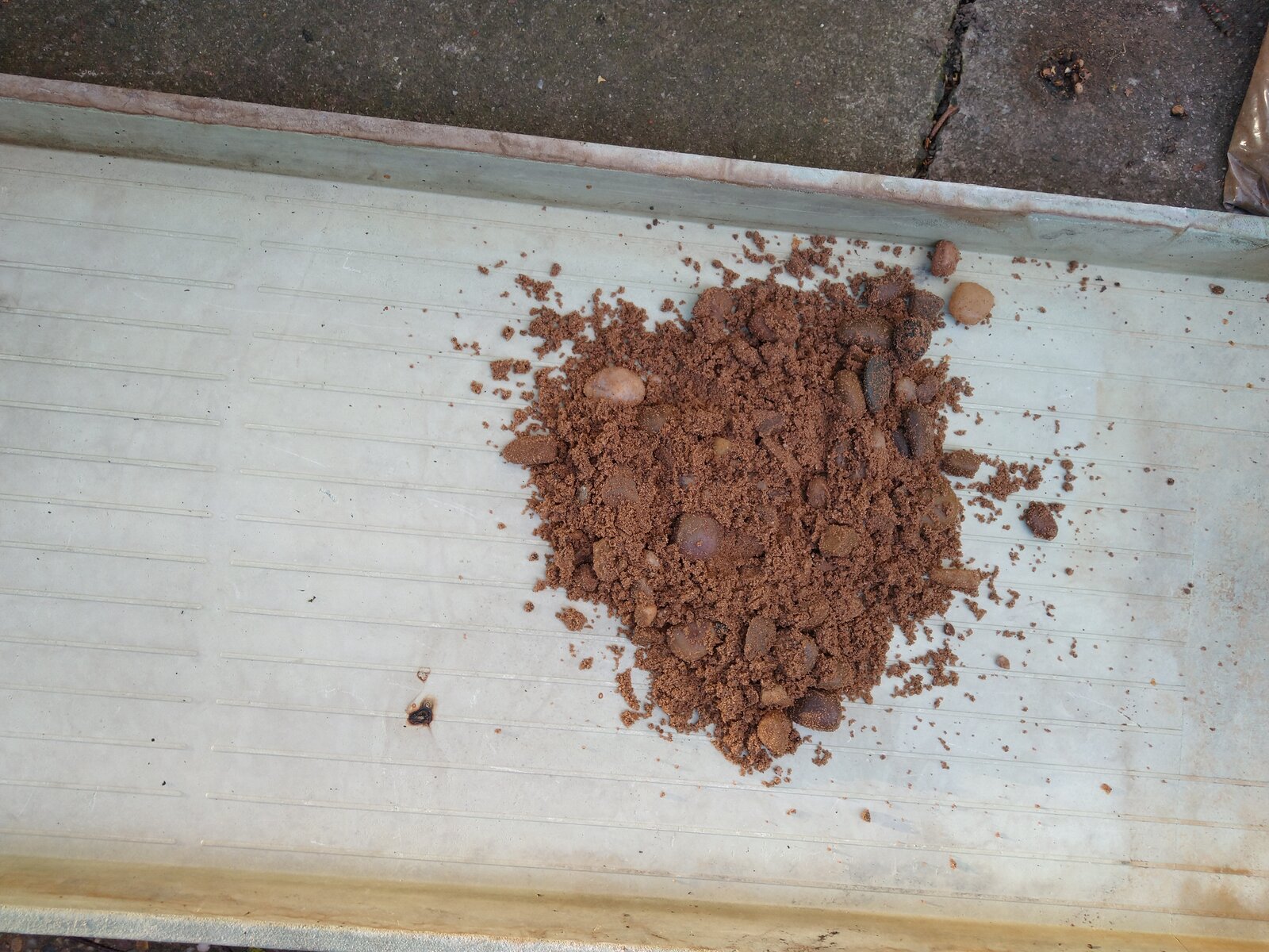

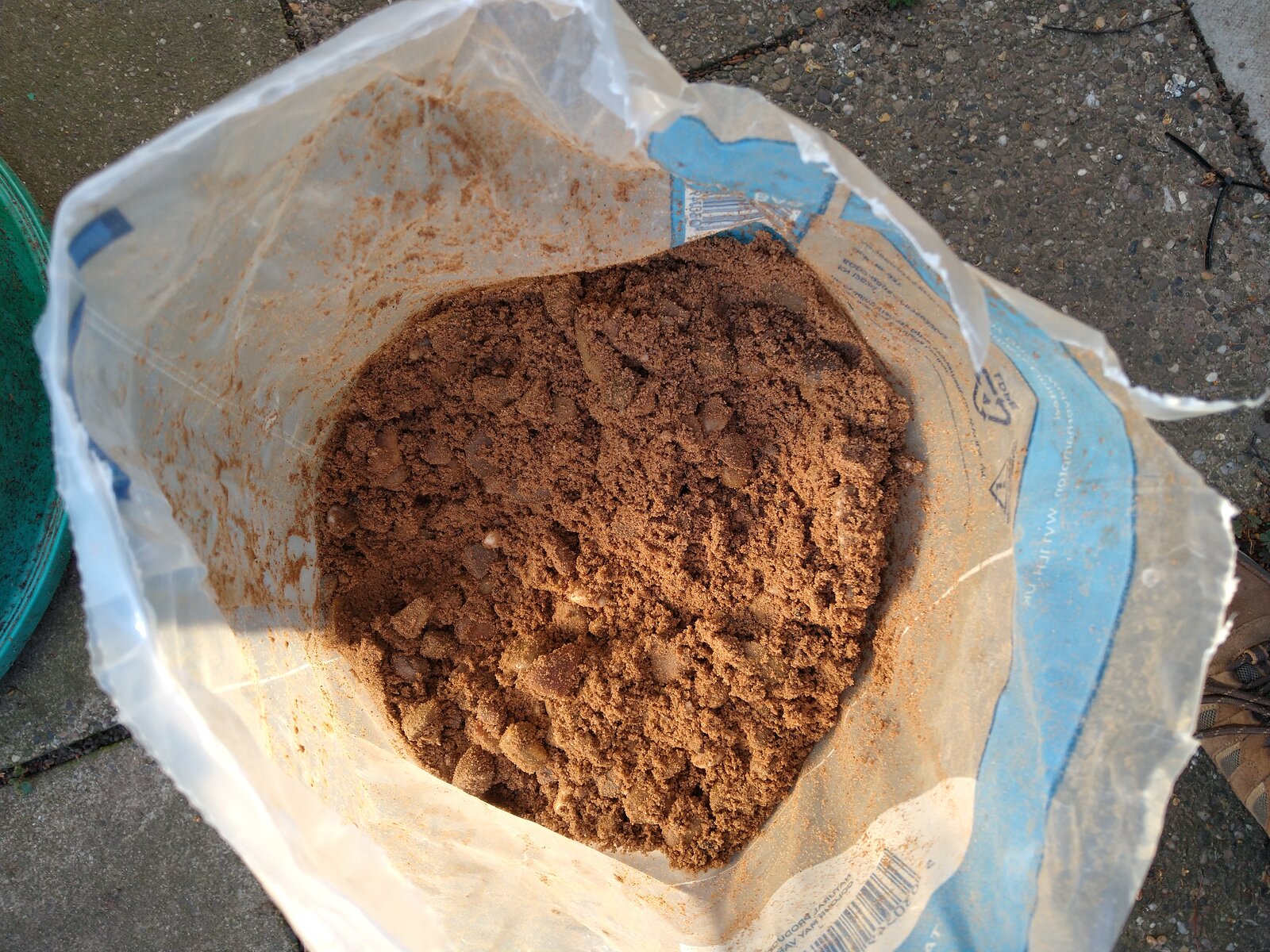

Hi all,
had some ballast delivered for my footing for a small conncrete block raised bed i am making. it seems to be a lot of sand and not much aggregate, is this normal i dont really know what its meant to look like.
thanks
The stuff i use is an even mix of sharp sand and then every size up to small (say 30mm) stones.
They key bit it all fits together to make a solid mass with no gaps.
Some images here:
https://www.google.com/search?client=firefox-b-d&q=wickes+ballast
thanks ive googled some images. some seem to have a lot of aggregate others dont. the stuff i got delivered seems to hardly have any aggregate so im not sure if its suitable. pucture below

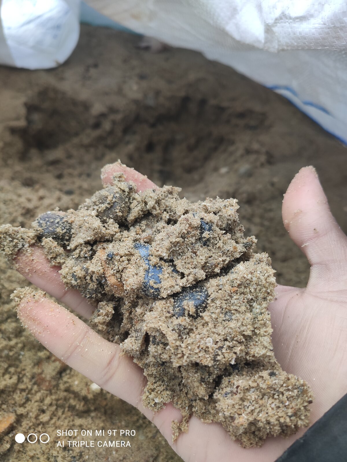

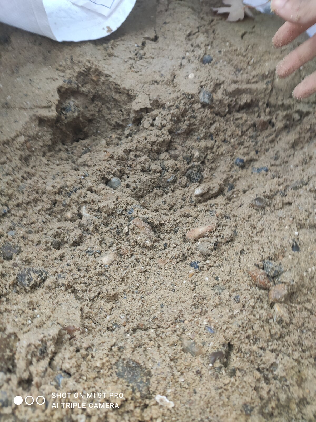

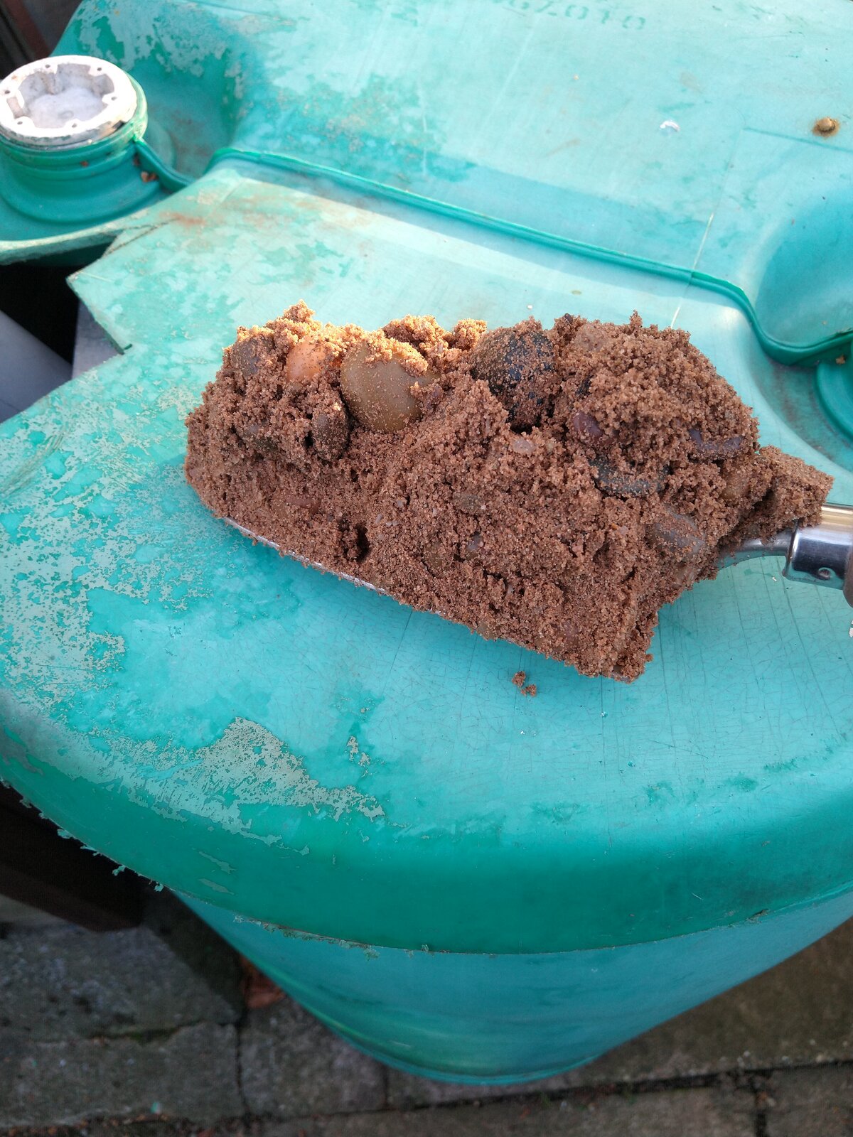

My stuff from BnQ
If it was delivered in a bag tip the bag out on to a board and turn it over with a spade a few times to distribute the stones around. This will give you a better idea how many stones there are. Sometimes they settle in storage though vibrating the load will tend to lift them to the surface. (The sand settles down into the small crevices and get under the stones thereby lifting them up).
Plenty of stones in there. (y)
