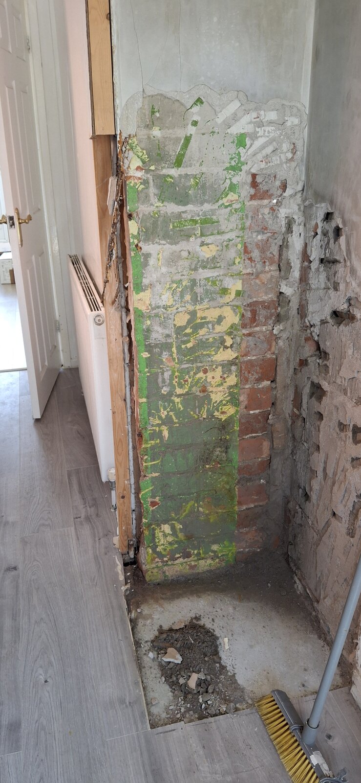

Whats going on here ?
26 Dec 2009
13
Lancashire
Need some help. This wall in the kitchen is wet through from the bottom up to about half way up. I have taken the plaster off as it was just falling off as its soaked. The wall is in our kitchen and I think its the original wall which now has an extension off it. Any help appreciated
More context needed...
Whats under the floor?
What is the other side of the affected walls?
Any drains the other side?
How is the roof of the extension connected to this wall ? Pics of exterior more useful than interior.
