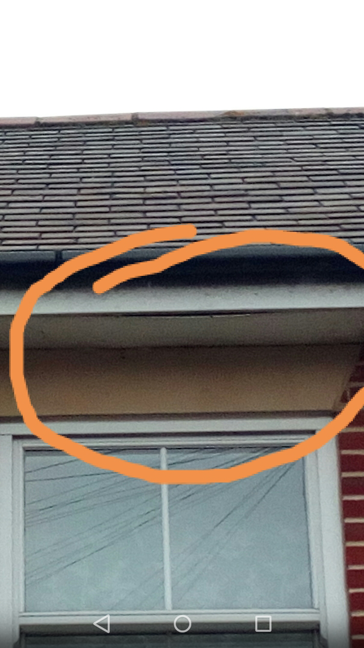

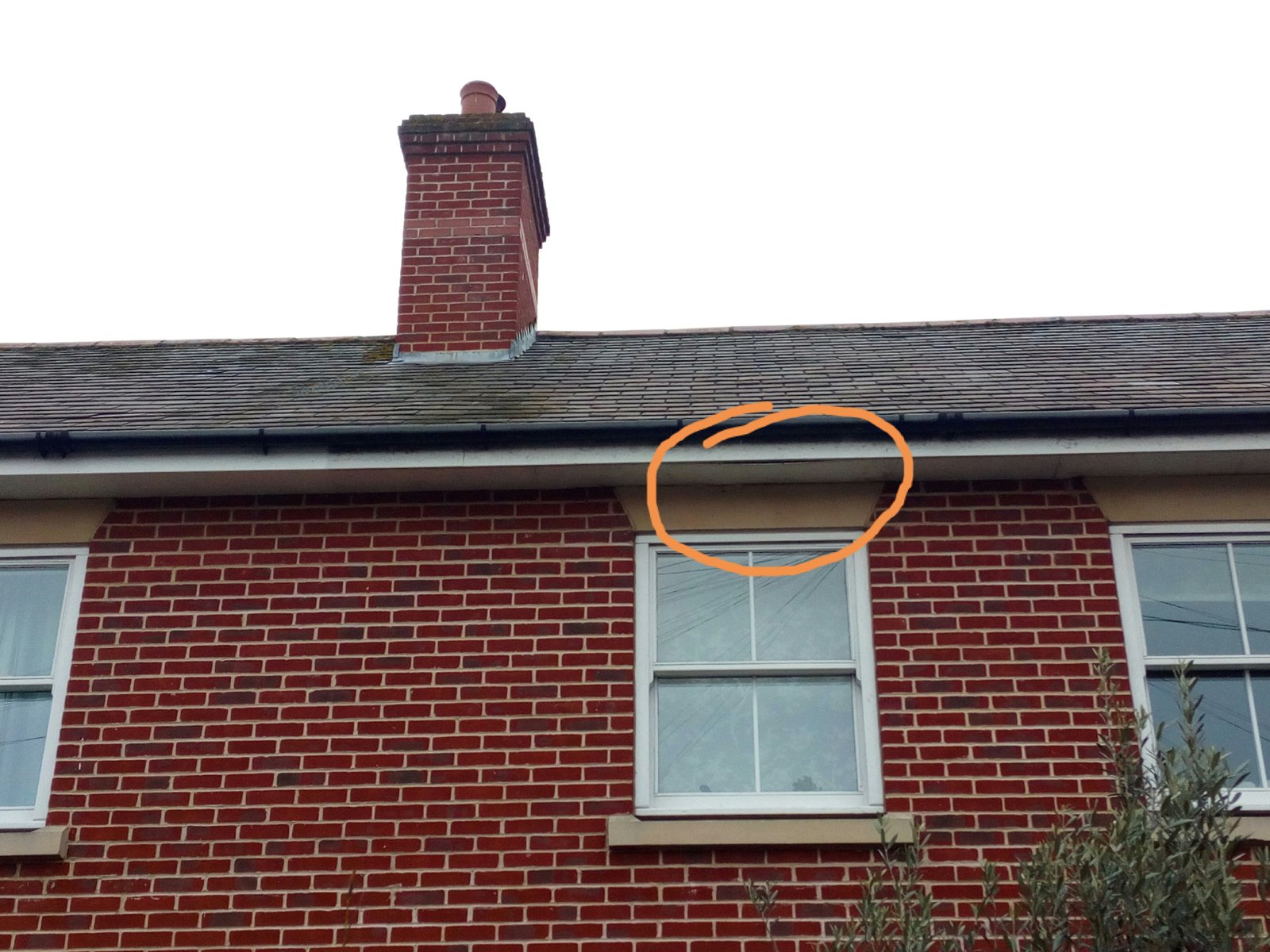

Whats happened here?
12 Apr 2018
I don't have any roofing knowledge,
Can someone tell me the cause of this and how much it would cost to fix it.
Also do you think the roof looks wavy? The house is only 10 years old.
The soffit is falling out. Reason , not fitted securely. cure, closer inspection needed.
Could be as simple as the fascia is only fixed near the top and the bottom edge has bowed out.. That should be obvious with your eye from the ground.
Roof wise, not perfect but certainly nothing to worry about.
Better than a lot of newly slated roofs to be seen.
