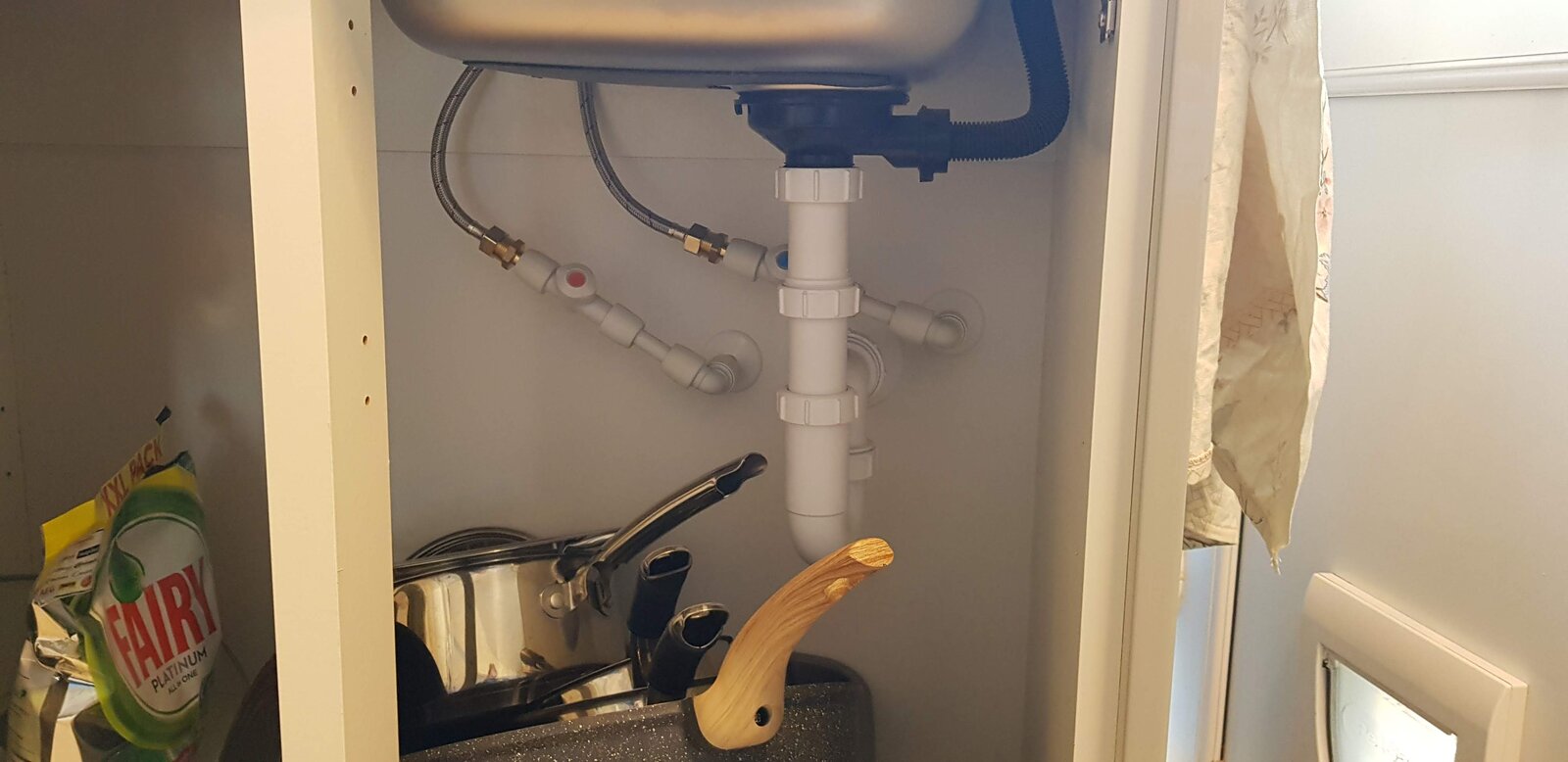

As per above .... is it for support or mainly to stop things falling through?
I'm installing my kitchen waste and need to drill a hole through wall, which i have established i am doing once i've got the plumbing rigged up under the sink so i can make an accurate hole.
For this, it would be much easier if the back panel was completely removed.
Either side of the sink is going an integrated D/W and W/M if it makes any difference.
So, my question is, what's the purpose of the back panel?
If i remove it permanently i'm assuming no issues? (Will probably keep bottom 6" to stop stuff falling through)
it can help reduce condensation issues inside the cupboard if the units are up against a cold damp outside wall , and make cleaning the cupboard easier. It can also making fitting simpler in old houses where the walls are not straight or vertical, re you can cut the sides without compromising the integrity of the inside of the unit. Apart from that it is just a waste of valuable storage space.

I have pretty much the same layout. Dishwasher one side of a 600mm base unit where the sink bowl is, washing machine the other, so the appliances add no support to the worktop. Like you suggest, I kept the bottom few inches of the back panel but there is so much pipework in mine (mains water in, water meter, outside tap, appliance taps, waste disposal etc. ) that it was just too much of a pain to keep the rest of the back panel. Our base units are all good quality pre-built and I'd only have been tempted to add cross bracing to that unit if we'd gone for a seriously heavy worktop such as granite.
The mains water in and copper pipes guarantee some condensation and even if you were to retain the back panel in a sink unit, there are going to gaps around pipes to let in spiders, woodlice etc. So like some others have noted, ours is cleaning stuff only in that unit.
