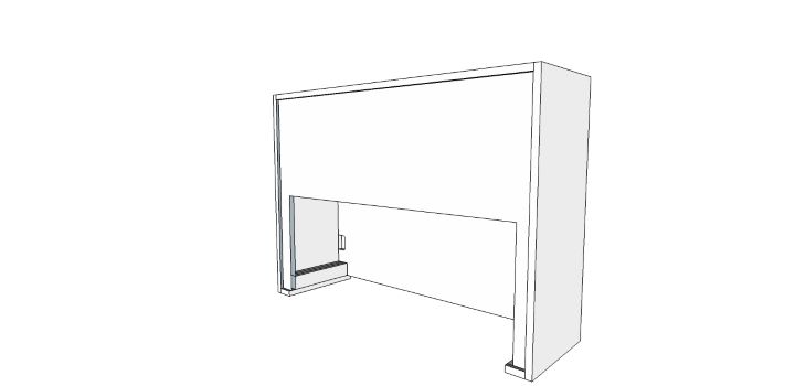

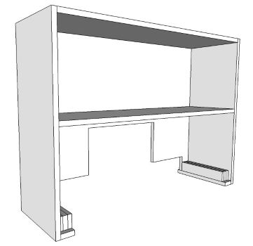

OK, so I don't have the item here in front of me, but I went and read the installation instructions (yes, really!) and this is what I think you could do, bearing in mind that the drawings don't have sufficient details (could do with a lot more measurements IMHO), so I am guessing a wee bit:
Cut the bottom out leaving a small nib at either side. On top of the nib add some packers. I am showing these as beiung two pieces of 18mm thick and one piece of 15mm on each side (so 51mm thick in total, which is about right) - but you could equally use two pieces of 3 x 2 stud and some packers to get them in the right place. They are about 250mm long, set in 18mm from the front edge of the cabinet, Ideally yo need to install these before doing the cut-outs, screwed in place through the sides of the cab and also through the bottom. They will allow you to install the 4 sidfe screws. The bottom and back can then be cut-out (shown as a scribed cut out here)

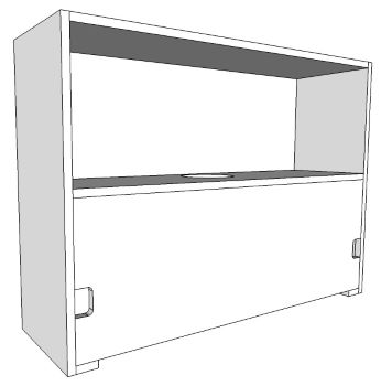

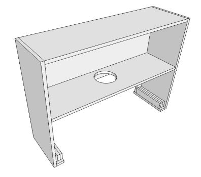

A new full depth shelf which comes right to the front of the cabinet is made and edge banded, drilled for the 150mm exxhaust pipe and fitted (screwed through the sides):

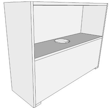

A removeable MFC blanking panel can then be made-up to cover this hole, This should be edge banded and needs to be 1 to 2mm smaller than the opening once made to ensure that you can get it in and out. You will need to drill a neat finger hole in it to be able to get it off if the need arises. It should be held in place with four Keku clips (see Hafele) or magnetic door latches:

The back cut out can be square rather than scribed - either way I advise that the upper part of the back is screwed or pinned to the back of the new shelf as it sounds like it is originally held in place by a groove machined in the bottom of the cab (so if you cut things out there will be next to nothing left to hold it secure) and things can end up getting pushed down the back of the cab as the 8mm stuff flexes, The following is a rear of cabinet view

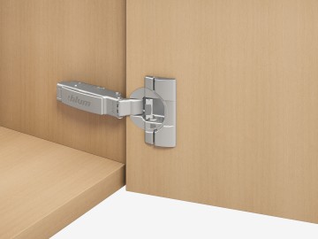

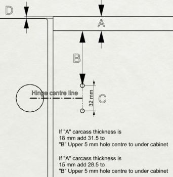

I suggest you examine the position of hinges in a standard upper cabinet. Standard kitchen doors use what is called a full overlay hinge which looks like this:
Note that the cruciform (mounting) plate is fixed with two holes set at 37mm in from the front of the cabinet spaced 32mm apart vertically (this is a fixed distance which all kitchen hinges are made to work to)

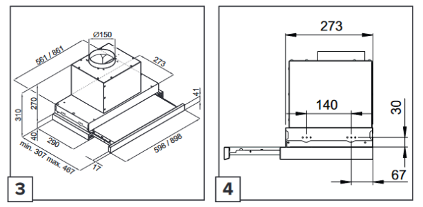

but the arm of the hinge extends even further into the cabinet, generally by about 50 to 60mm, depending on the manufacturer, type of hinge, etc. Your extractor body is shown on the drawing as 273mm deep:
whilst upper cabinets are generally around 280 to 320mm deep (front to rear - you didn't state the depth of the cabinet in your original post), so if the extractor is 273mm deep off the wall and the cabinet is, say, 320mm deep, that's a difference of 47mm (320 - 273 = 47). If you place a removeable cover over the front of the extractor to hide it and the back wall (which you said you wanted to deal with as it isn't plastered), that 47mm is reduced to 29mm (47 - 18 = 29) which isn't deep enough to accommodate a hinge sticking 50mm into the cabinet plus thethickness of the hinge which sits above the surface of the door. So, you either have to put neat cut-outs in the front cover to permit the hinges to be there, or you can side-step the issue by going for a top hung door as in the examples I quoted above
