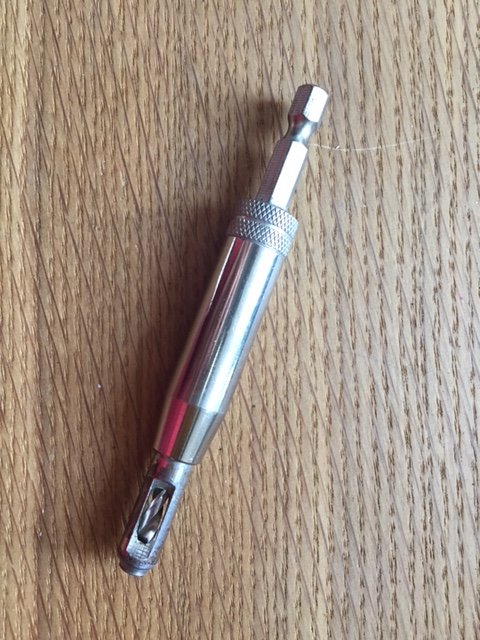

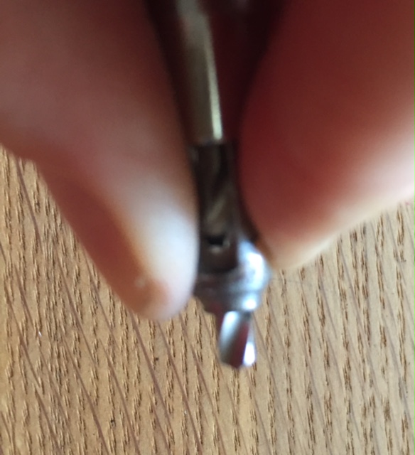

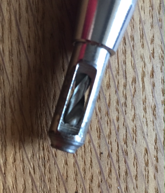

Left behind at my place by a tradesman many moons back. Can anyone tell me what its use is?
Basically a drill bit housed within a retractable cover. Countersink?

i dont know but assume countersink by the shape off the outer sleeve
and rather than pilot a shank hole as its to large for a pilot as it would remove all material

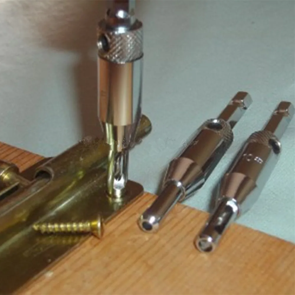

It's a self centering pilot bit for drilling exactly in the middle of a hinge hole.

ahh that makes sense so the sleeve doesnt turn then ??
it just locates in the hinge countersink ??

It is a pilot, just a very large one, maybe for a number 12 screw, which is probably why the tradesman never came back to retrieve it, probably never uses it and never realised he had lost it!

Correct, it's free to rotate, ie, doesn't rotate in use! They get really, REALLY hot!!!

We call them Vix bits. They only get hot in use if you don't clear them out (of swarf) and don't lubricate them (oh, and if and they are cheap Chinese copies). The Trend Snappy versions are a million miles better than cheap and nasty Chinese copies illustrated. And, B-A, most modern fire door hardware requires 4.5 or 5mm screws, not #7s!

Thanks all. That adds up as we had doors fitted a few months ago so I now know who's bit it is!
Gaz - to answer your Q, it's states #12 on the side.
