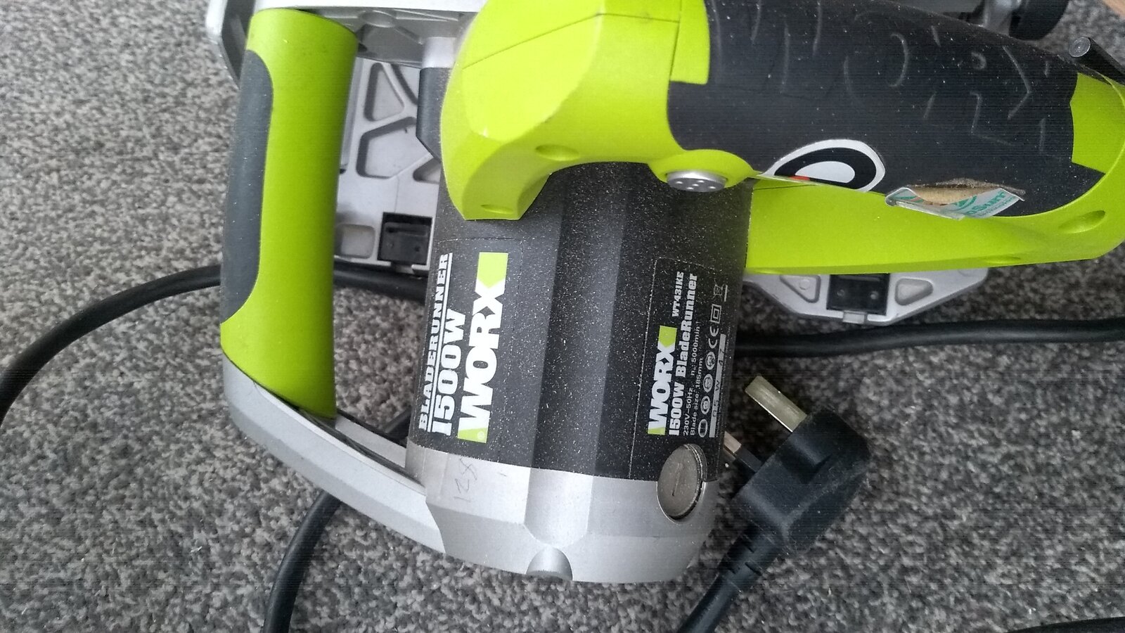

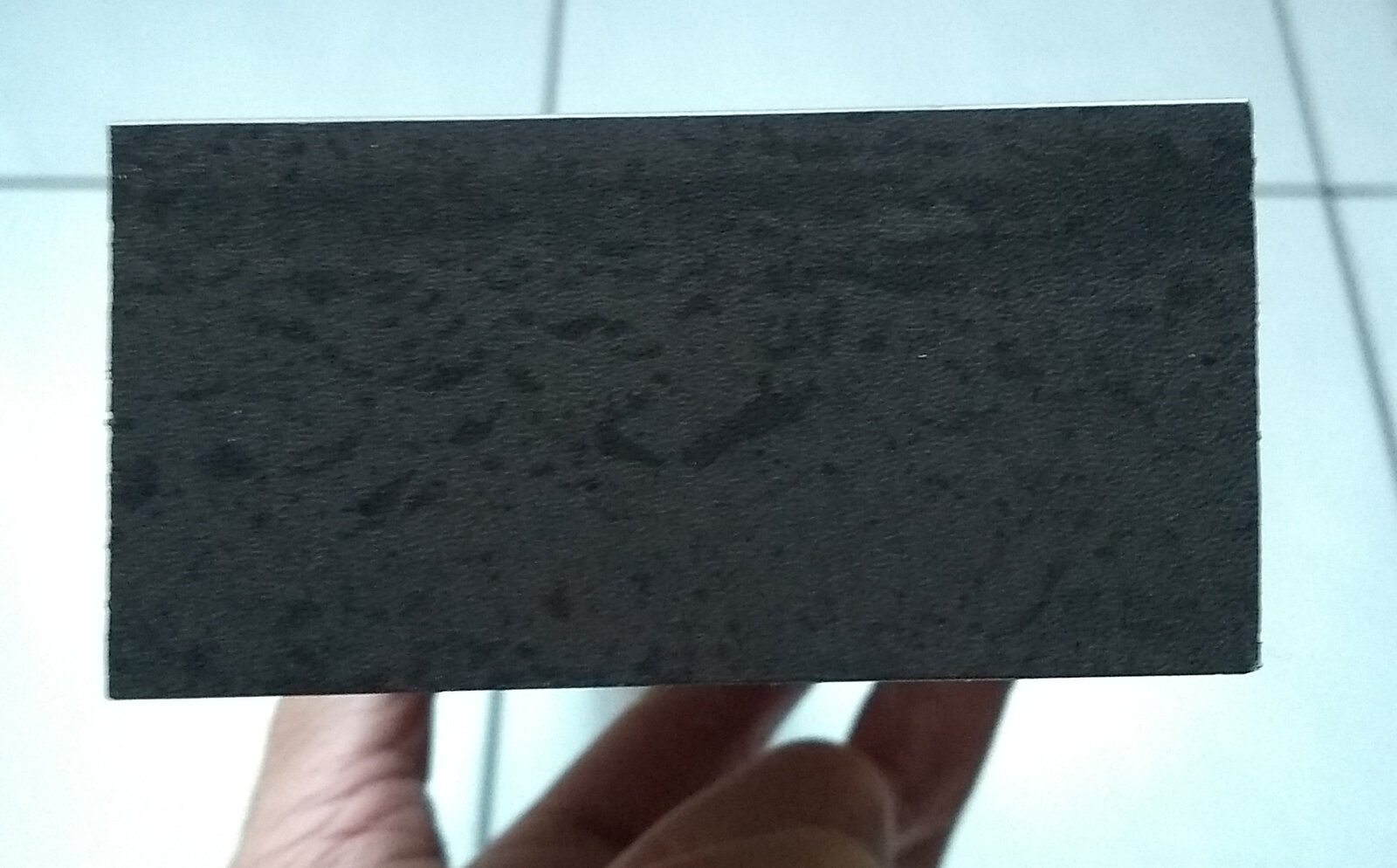

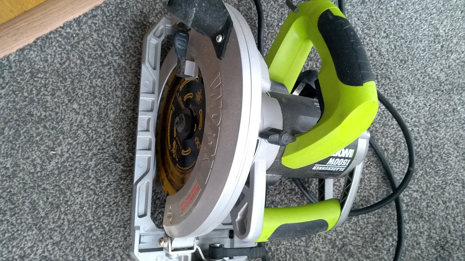

I am cutting kitchen worktop and used a circular saw and noticed the end of the cut is not square where the start of the cut is. Its a works saw with a De Walt blade. Is it technique or is something else going on.
See left side bottom is not square. You are looking at the front edge of the worktop I started the cut from the back to the front. The right side edge in the picture is the factory cut. Its not that rough its just pixelated - the cut is very good.
For my next cuts I plan to cut slightly oversize and square off with my router. Or put it on my table saw as some pieces are only 1m and 500mm

Its a 24tooth not new but good enough not to give chips to the serface . Fence I am sure was parallel I did do it upside down. I had it on the ground chocked up to clear the blade teeth only just sticking out, and then straddled the worktop so my body was in the middle and could reach both ends comfortably. Havnt cut anything this thick before so never noticed.
I have more to cut today so will pay particular attention to my technique and then check the results.
the worktop must be fully supported so when the final cut through nothing moves
I have worked out that is part of my problem. I have been cutting on sponge to protect the worktop from scratches, but I have done a few more cuts today on the sponge but paid very close attention to my stance and positioning and concentration at the end of the cut and now it is square, I think I was trying to "follow through the cut but must of lifted and twisted at the end.
I have more cuts to do but will be lifting the worktop off the floor on wood and not sponge.
I am fairly experienced with the saw and other types of power saws but maybe that was part of the issue and I was perhaps being too cocky at the end lifting it up and out of the cut. Having said that I have only ever cut 15-18mm stuff with it before which would not of mattered/ noticed so much.
If you look at the wonky cut you can see that is exactly what I have done - that is the end of the cut and I have lifted the saw and its tilted away from the body or the work piece.
Need to concentrate on keeping it against the fence and flat on the work piece.

Its a 24tooth not new but good enough not to give chips to the surface
24 teeth? On what diameter blade? 165mm? If so you normally need more like 40 to 50 teeth (at that diameter) to guarantee cutting a laminate worktop cleanly and in a perpendicular plane. You ideally also need a ATB (alternate top bevel grind) blade. Also what kerf is your blade? Very thin blades have a tendency to bend in the cut on thick materials - as indeed do blunt or dirty (resin caked) blades. I'm not saying you absolutely need the right blade, tooth profile etc - just that the further you stray from the ideal the more likely you are to get a bum cut
BTW skip the sponge. Any cut needs to be supported on a solid surface, e.g. a couple of 3 x 2s supported on trestles

The other thing to note about plunge/track saws is that they mostly have twin lockable pivot points, one each to the front and rear of the blade. A conventional rip saw with a single pivot point at the front can easily have the saw "bent over" (i.e. the base of the saw flexes) by the changing of the direction of pressure applied to the handle at different points in the cut (i.e. as you are reaching further over the material). This occurs more with saws which have a sheet metal base than it does with an alloy base, but it can happen with many saws. On reflection that is probably your biggest problem

The saw in that respect is very good as it has an alloy base and the saw handle can rotate as you move

Its a dewalt 24 teeth 71/4 blade. Yes also a thin kerf. I should of done more research and got a better blade for the job. The factory edge is actually very good on the worktop so I have used that on critical areas ( I have 4 with 2 tops ) and the bad cut I made in the picture is in a place where its not seen/ noticed. The last couple of cuts will only be 500mm wide and those will be going on my table saw after a rough cut with my circular saw. Table saw I have a 40 and 60 tooth blade to choose from.
