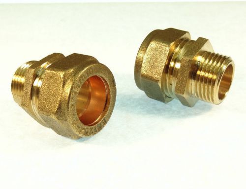

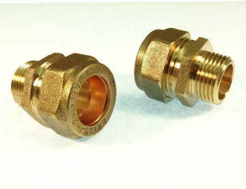

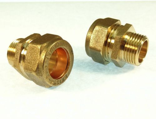

These are the fittings that I purchased.
The person selling the tap says that the flexis have a 3/8ths connection, they clearly aren't 3/8ths BSP. I am wondering if they are 3/8ths UNF or some other standard.

Maybe your flexis are 1/4". Male fitting for that is about 13.5mm OD. I Googled 1/4 inch copper pipe fittings and something by Conex-Banninger from RS Components looked promising - 15mm compression x 1/4" male. Couldn't see anything on Screwfix.
You said "By my maths, 3/8ths is 9.5mm", but that's irrelevant. 3/8" is the nominal bore, pipe OD is bigger, I've given OD for 3/8" and 1/4".
