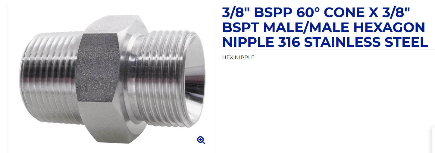

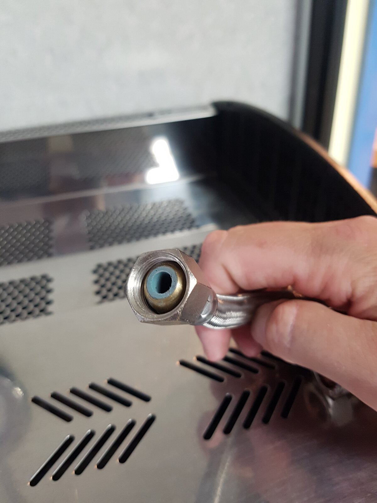

Hi all
I have a 3/8th's compression fitting from a coffee machine that I need to connect to a 15mm pipe. There is a 15mm isolation valve in there at the moment but the only 15mm - 3/8ths isolation valve I have is a flat face on the 3/8ths side.
Wasnt really game to try the fitting on a flat face.
Any ideas on how to connect the 3/8ths fitting to a 15mm including an isolation valve?

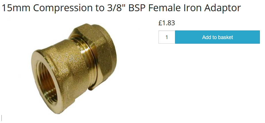

So if I come out of the 15mm isolation valve to another piece of 15mm then the coupler?
Nice one thanks, I was too caught up trying to find an isolation valve to do the job rather than the straight forward option.
Sounds to me as if the "flat face" is designed for a flexible hose with a sealing washer between the two flat faces!
