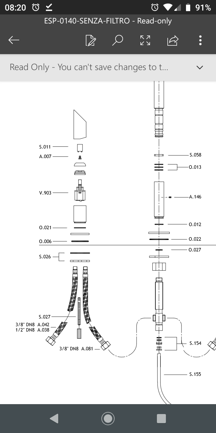

I have a kitchen sink I need to replace. The 2 taps and water spout (I think that's what it's called) are all separate.
See pic below:
Ideally... I'd like to just replace the cartridge, but I can't open the dome.
In another thread posted on this forum, I got replies saying I could remove with some effort.
I simply can't do it. I can't get a grip:

The make is MGS, not MSG as on your other thread - there is a manufacturer and UK suppliers etc who should be able to help - but wait till you see the prices - about that of a usable second hand car, for a tap!
@cdbe
thanks for the heads up
i will get someone to have a look for me
