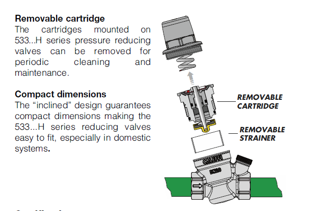

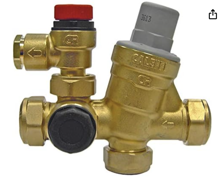

I'd like to clean the mesh filter. Cylinder manual says "Unscrew the head in the inlet control set and clean the mesh filter within". Which bit is that? (I know to depressurised everything before, don't worry) Thanks

# Range TS201 or Caleffi inlet control group multibloc 3/6 bar
The 'head" in question is that grey part. Manual says to unscrew that part then use some grips to pull out the internal cartridge using the exposed hex head. The mesh filter will be then accessible. I pulled with all my strength but couldn't get it out. In the end I bought the entire multibloc and replaced it.
Before throwing out the old one, I again tried to remove the internals by pulling on it. Basically impossible. I had go through from the opposite end to hammer the thing out.

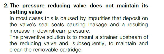

In the end I had to change the multibloc anyway because the pressure reducing valve was letting by. I looked at the rubber seal and half of it had eroded away!

Firstly the PRV valve on the cylinder was constantly letting by. I had a big company come out and at that time I new nothing about unvented pipework. They charged the vessel up to 3 bar as it only had 1 bar in it. It hadn't been serviced in years (that will change). And they said the cylinder PRV was faulty and wanted £250 to fit a new one not including the £80 call out. Having seen the PRV online for £20 I thought that price was a bit steep so I found a local bloke who did it for £60. They saw I do a lot of DIY so explained how it works a bit.
After the PRV was replaced there was still water going through the tundish so I spoke to the plumber and they said it could be the Expansion Relief Valve on the multibloc. The plumber said that I could do it so I did some research and changed that.
After those two were replaced the ERV was still letting by but only when the water was being heated up. I noticed the manual opening knob was very very easy to twist to let out more water so I suspected it was getting close to it's rated 6 bar. Checked the pressure of the EV and it was indeed just below 6. I also checked that the diaphragm wasn't blow or the valve wasn't leaking. Relieving all cylinder pressure the EV returned to 3 bar. But when I closed tap and put mains back on the EV would creep up to 4.5 bar without the boiler coming on.
So spoke to the plumber and someone else on this forum and they said it could be the pressure relief valve that was letting by. Made sense, so changed the multibloc. While doing so I made sure the EV was still at a pre-charge of 3 bar. Looking at the old valve and seat on the pressure reducing valve half of it was eroded away so that was 100% an issue.
