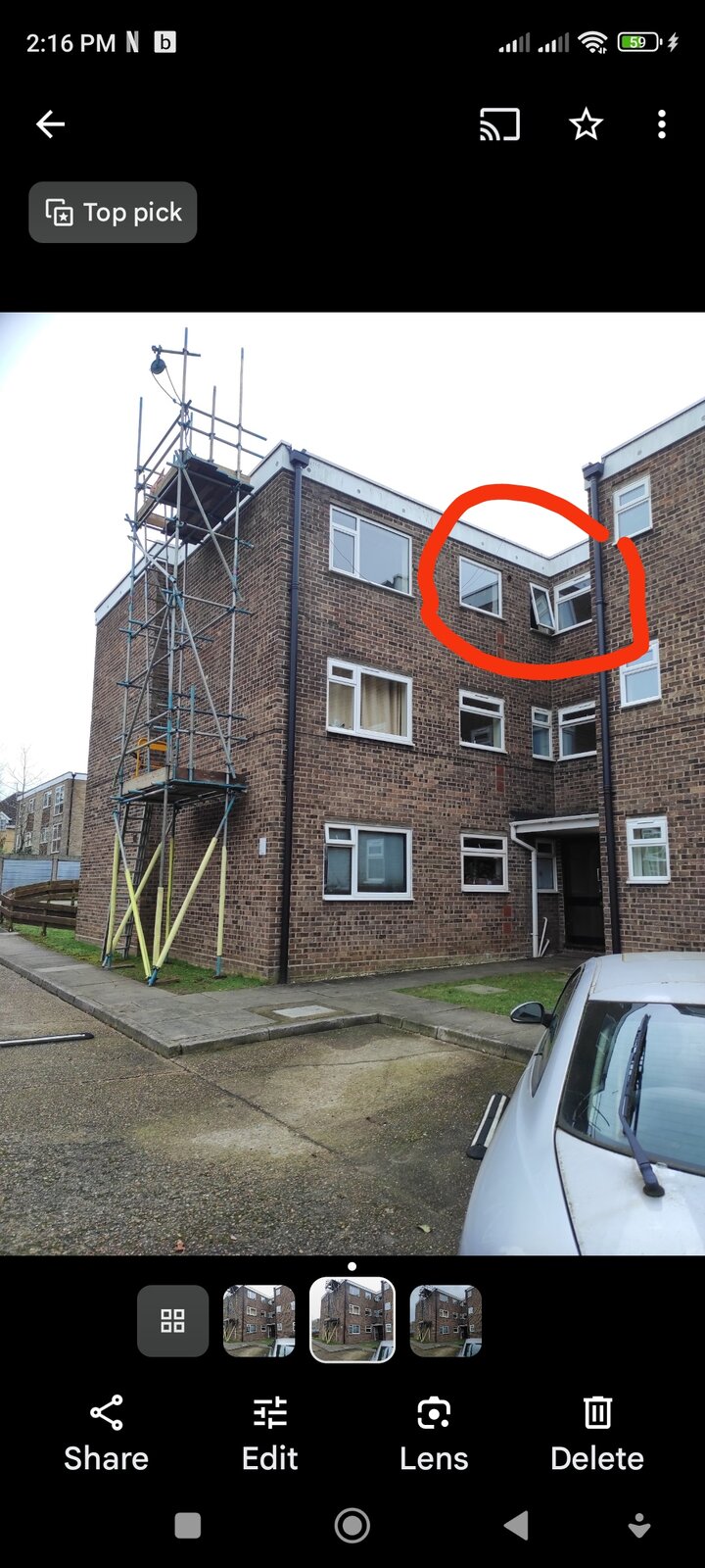

Hi, we want to add a drain on the flat roof above the circled section in the photo. Struggling thinking where the pipework should lead to though? As you can see underneath there's a small roof parapet, so it can't go straight down or can it? As it's a flat, going sideways might not suit the design of the building. Any thoughts please?
To the left of the small window then vertically down into a hopper above the porch which will feed into the white down pipe
why don't you use the existing downpipe from the roof?
