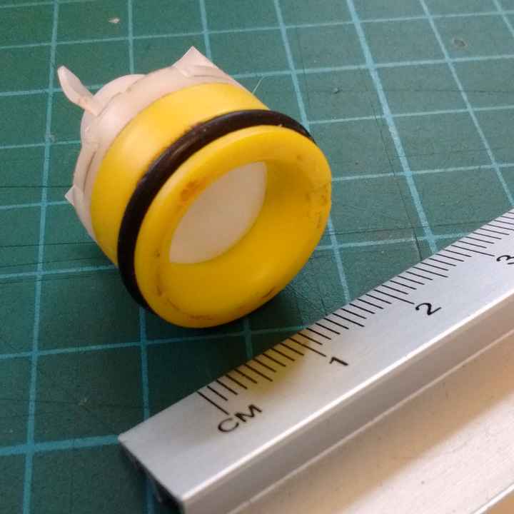

For my thermostatic Bath taps I cannot find anyone supplying non-return / Check Valve inserts with o-ring and with an outer diameter of 3/4" / 20mm. It is the same thing that goes into the back of a bar shower, but has a larger outer diameter.
I need a new one as the plastic has failed on mine allowing cold water back into hot water side.

Stick a couple of standard check valves on the hot and cold supplies,.

Thank you. Adding standard check valves is my next step if I cannot find these plastic bits. I was hoping (obviously naively) that I could be lazy and cheap and simply replace the plastic bits.

Why is it backflowing, are your hot and cold supplies to the shower not from a balanced supply? If the hot supply is LP then is there one in the hot side you could swap over?
Madrab,
My flow rate is low, and the hot and cold flow rates are a little un-balanced (I presumed from the flow resistance of the boiler heating plates).
Last year my shower started getting cooler, and it was suggested that "Possibly a mixer is passing between the hot and cold". I found it was actually my Bath Mixer that was passing between the hot and cold and was affecting my shower. As a quick fix I left the Bath Tap thermostat on 'hot' as this stopped back flow. Read more: http://www.diynot.com/diy/threads/h...ks-worcester-r25-r30-he.447865/#ixzz4J6JNqtRt
Today I had some time so had a look and found that the I found that the Bath Mixer had a failed check valve on the hot side and soon to fail on cold side. So started my failed search of a simple replacement.
Good suggestion to remove from cold side and put on hot, but I think both are failing (weak plastic).
