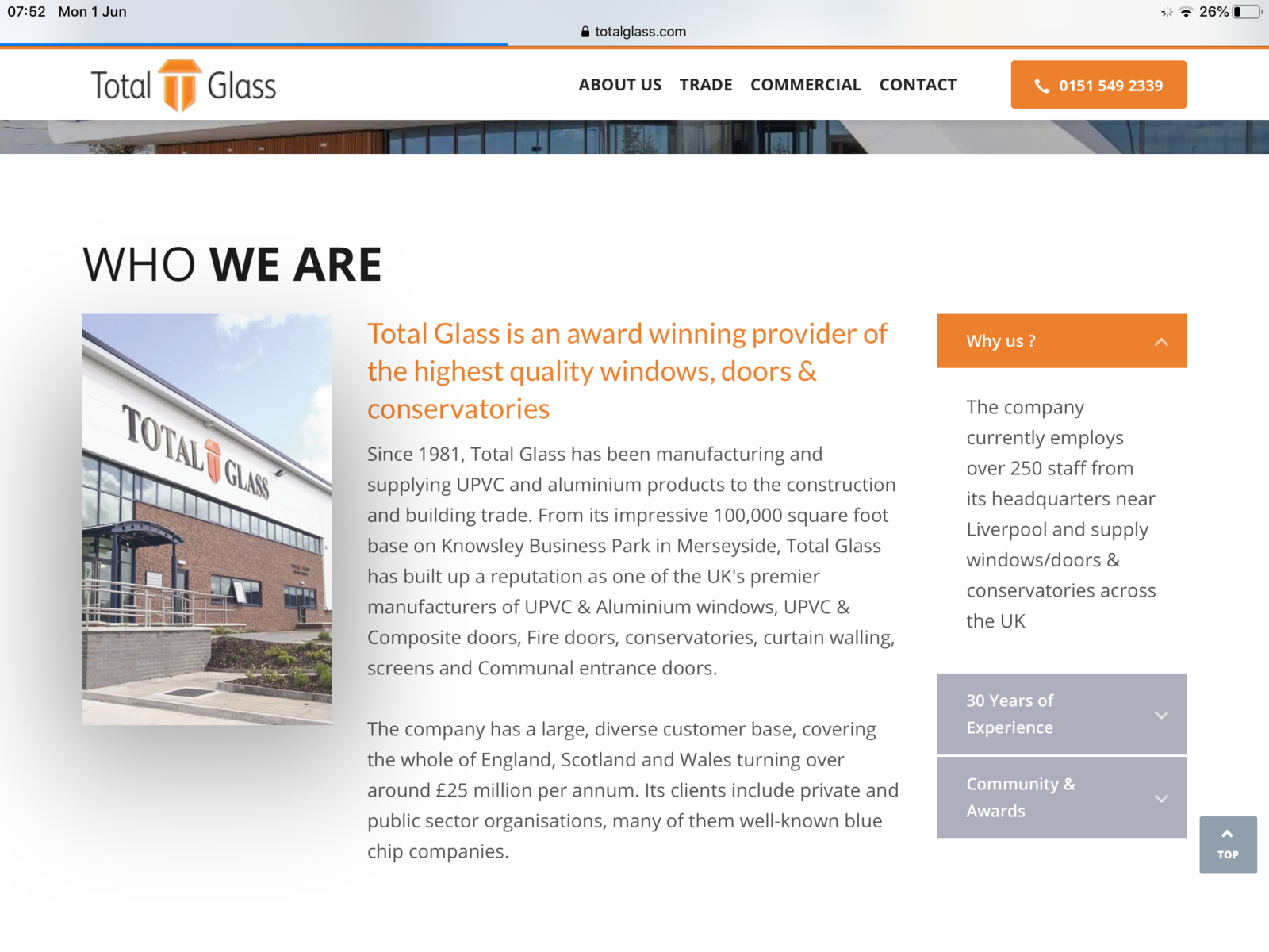

Try total glass there in Liverpool, Prescott.
