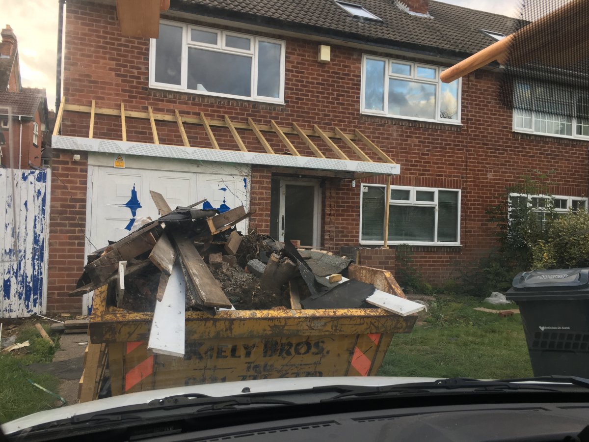

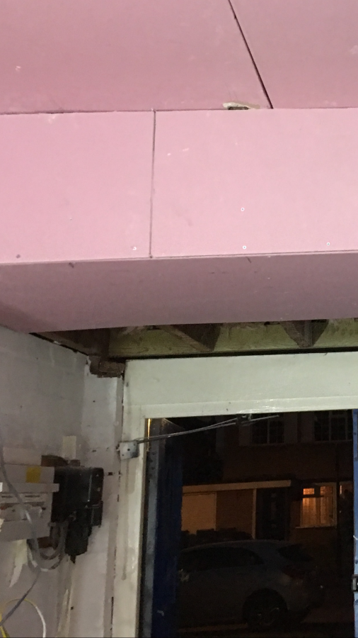

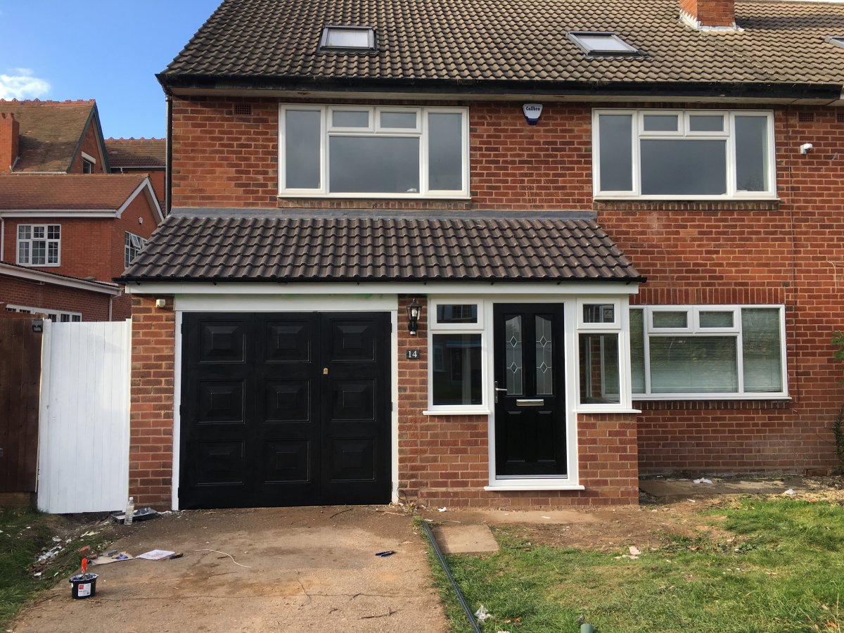

we built a porch to the right of the garage and added a pitched roof. I realised we haven't put roofing straps but realised I should put them ideally each side of the garage door.
What do you suggest.

I suggest not bothering. That roof is hardly going to blow off any time soon
If he was joking he would have said 'down the centre of each window and 2 on the door' ;)
I'd put a couple either side of the door like you said.
