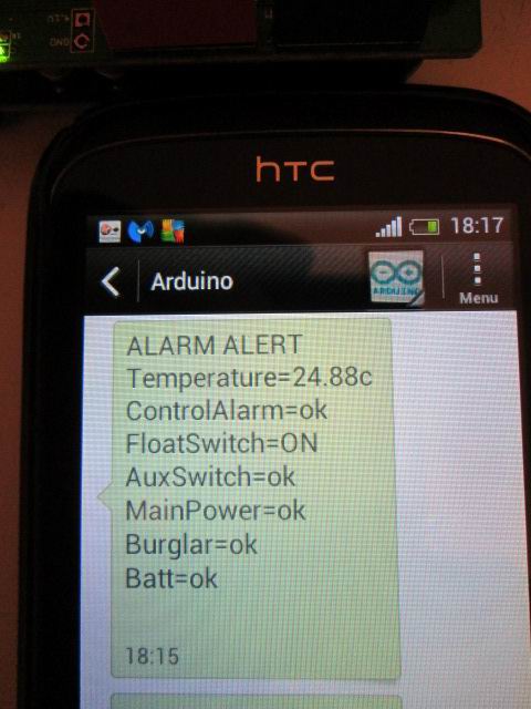

As for future needs, think these units will meet our simple needs, though again the Honeywell Accentas do come with their " communicator" outputs for connecting to dialers etc, but cannot see anything similar on the Texecom Veritas.
Already have a separate sms device and cctv/pci card that could react to the signals from the alarm unit.

Nice.... I have similar using rpi and openhab.
Never used the rpi, seems like you have to plug so much on to it, just to get it running, vs the arduino and a simple usb cable.
Never come across Openhab, looking interesting ,will have to give it a closer look.
