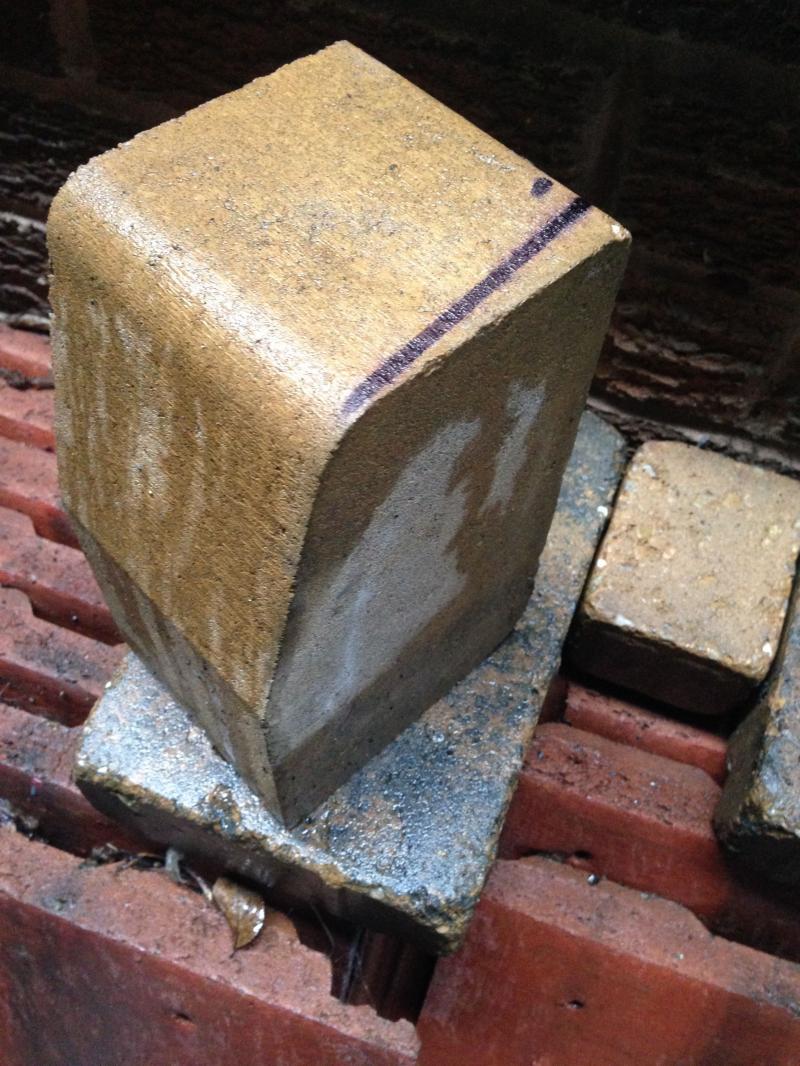

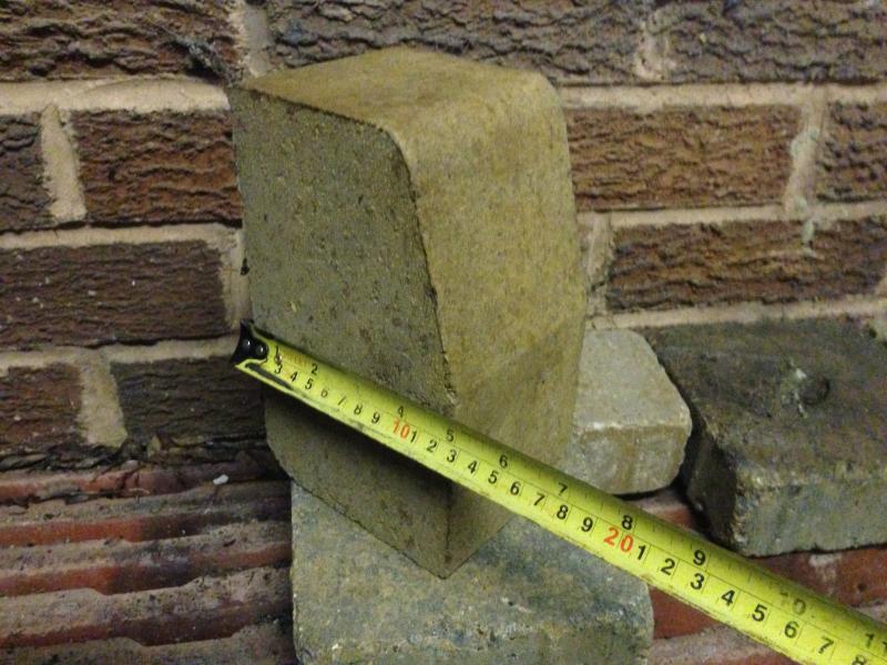

I need to cut some kern adding blocks on my DIY block paved path project, and I'm seeing this as an opportunity to buy myself a new power tool. I know I could hire a Stihl saw, but which size/type of angle grinder would be best suited?
I see Screwfix categorise them into two sizes, 115-125mm & 175-230mm.
Heres one of the kerb blocks I need to cut to create a curve...
I picked up the 9" titan one for my diy driveway, bosch diamond disc from ebay, worked fine and seems to be very popular if you go by the number of reviews (not necessarily accurate I know!)
I'm using a Clipper (aero jet evo 230mm) at the mo' and liking it a lot.
Trouble is with diamond blades is if you buy cheap you buy 5 times.
I have to say with an angle grinder I would probably buy a cheap one, if you're not using it loads.
They're so simple there's not much to go wrong during anything other than industrial useage.
I've stripped a few over the last 2 years to adapt into other forms of machinery and the gearboxes seem identical whether you buy a £20 one from Costco or a Dewalt.
The blade however, I'd buy a decent quality diamond blade.
