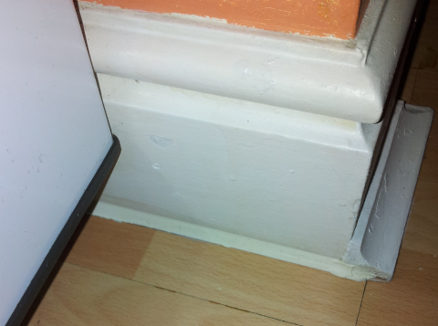

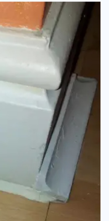

Here's a 2 year old hybriflex 480 bead. It hasn't failed.
For cracks caused by movement in joints, I use hybride polymer sealant.
Got any pics? How does it look post decoration?
