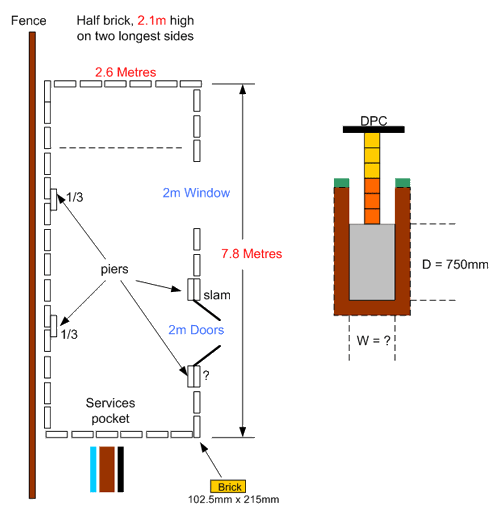

Here is my revised diagram, any comments :?:

You are right on 300mm wide found, done quick calc and weight is just over 15KNmetre run so will scratch in to 300mm wide trench. Only thing with 300mm wide trench at 1 metre deep is that even our smallest lad can not get his shoulders down it to bottom up.

brewhut, Will try and pick the bones out of questions and answer them As previously stated I will only give answers that comply with BRs and any thing I now suggest is for advice only and your decision whether you carry it out, but believe me I would not say it if it would not be okay.
Repeat, suggest change window to flank wall to light length of building.
Now read carefully, because I am not going to repeat it again.
Reduce width of excavation to 300mm.
Reduce depth of foundation to 750, below existing ground level.
Reduce depth of concrete to 600mm.
Leave foundation out under doorway. Throw shutter board across brick footings at this point and bed door frame onto oversite concrete.
Reduce oversite fill to 75mm, but wack well..
Concrete needed for foundations, say 3.5m3. Work it out yourself.

Brewhut. Services. Drainage, you say is going to soakaway, assume this must be storm water. any other drainage you require put outside.
Water. Make up hockey stick. 3m of 110mm PVC pipe, Cut bit, say 1.2m long, 90 degree double socket bend on bottom, dig slot down inside wall of trench where you want connection, 100mm wide by 100mm deep. Stand pipe up in slot measure length required to go across bottom of trench plus 100mm. Fit into bend.
Tunnel out on bottom outside wall of trench 100mm so that you can push hockey stick into this pocket, and it stands up in the slot the other side. Before you put it in, drop pull cord down pipe, tie of top and bot. stuff bit old cement bag in pipe top and bottom, pack bit clay round pipe in bottom of trench.
Do the same with the electric, but in 40mm waste pipe, or buy a pre made electric hockey stick.
We dig water in at 750mm deep, electric 500/600 deep, with warning tape across electrics.
You will be a little lean on piers door side. You will be okay, but if I was doing it for myself, would throw another pier up against window.

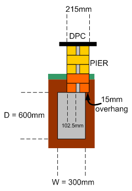

More whittling I’m afraid with yet another diagram :roll:
I assume with the sizes we have at the moment the pier will overhang the footing width (W) (see diagram), therefore should they be made wider where the piers are :?:
Also made longer over a certain length (L) to make sure the pier can be built ok in the correct place. I don’t know say (W) 500mm x (L) 500mm pad :?:
Bingo..
