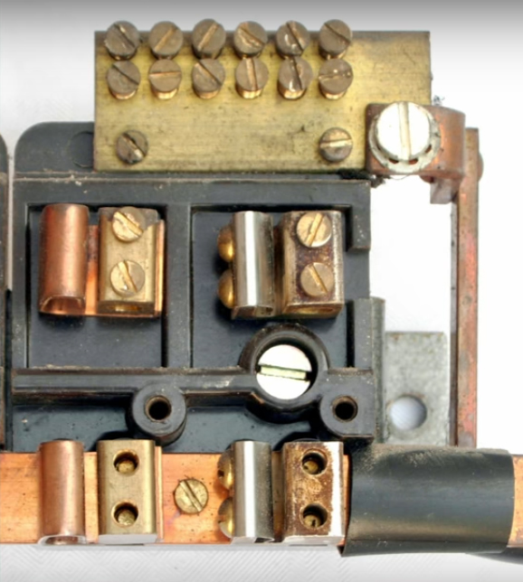

Although my old house the Wylex fuse box was RCD protected, Wilex-board-with-RCD.jpg this is unusual, also the old Wylex can only have over 32 amp in one slot which has reinforced contacts Wylex heavy duty.jpg and the main switch is limited to 60 amp Wylex 60 amp.jpg so at some point in the future your likely to want to change it for a modern consumer unit. It took me 6 months after I moved into this house, but the problem is without RCD protection although the regulations are not retrospective so existing things can continue to be used, at some point you will want some thing which means RCD's need to be fitted, new shower, new boiler, new socket, etc.
