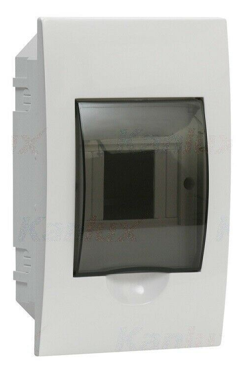

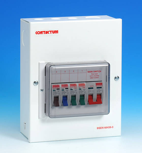

So we need to use some common sense. Personally I would select different products, the 32 amp supply to cookers has been standard in this country for years, and if a cooker be it oven or hot plate needs a supply lower than 32 amp the fuse or other overload should be built into the appliance. You can get flush consumer units 1692070371179.pngbut they still look ugly, my mother had something like this 1692070494871.jpeg on the wall in the kitchen, it looked ugly, but we had little option, dad said "I am not living in a building site, you can rewire the house when I have gone." so SWA cable was taken around the outside of the house to supply the kitchen as the existing rubber insulated wiring was in such a state, house was rewired after he died. But the kitchen consumer unit remained, it was supplied from a 45 amp MCB in the main consumer unit.
