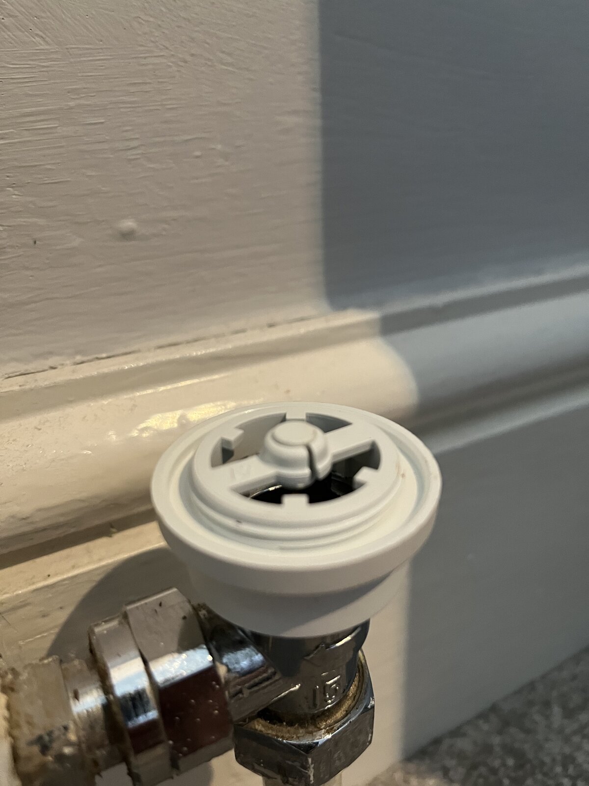

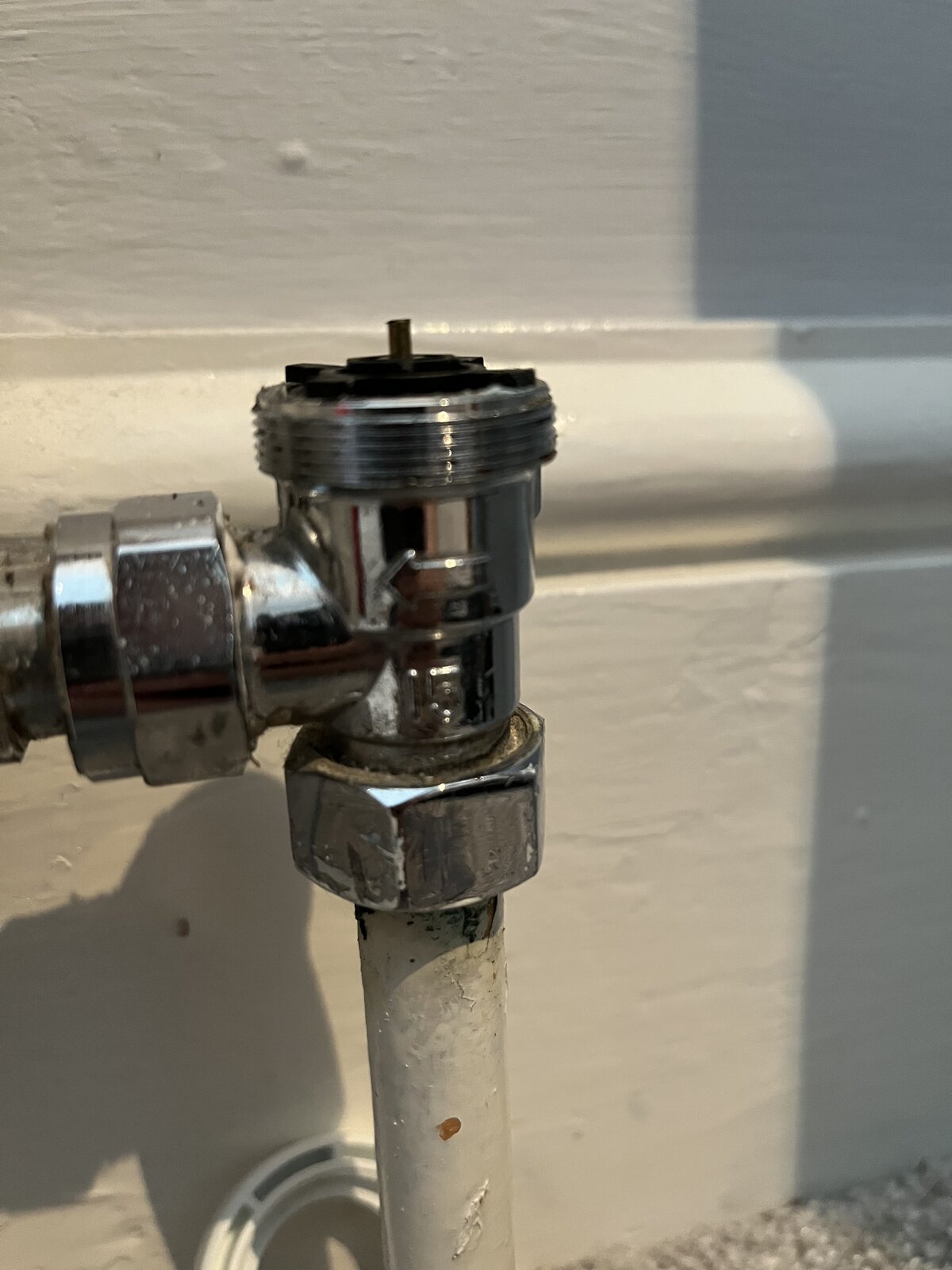

Hi,
I’m struggling to find which adapter I need for my hive smart valves. Any ideas?
The photo with adapter is the M28 which hive subsequently provided when I discovered the standard adapters also didn’t fit.
For context, it’s an old house. We’re also on oil just in case that might help to narrow it down, not sure it will though, any insight greatly received!
Thanks, L

I don't understand, does the M28 adapter fit the top of the valve, if so then the HIVE TRV just screws onto that?? If that adapter doesn't fit (too small?) then it would normally be the larger M30 adapter. Or is the M28 too big?
Have you tried the adapter guide?
The photo with adapter on looks damaged, maybe this is why it doesn’t fit properly?
Thanks for both your replies.
@CBW - I've checked all the adapters and they're all like this so confident they're not damaged.
@Madrab so the m30 thread is too large and subsequently the adapter won't screw on. The M28 adapter is the correct thread size but the white 'pin' sits far too high above the metal pin of the radiator valve so it can't press/depress the metal radiator pin.
What I need is a M30 type/design but with a M28 thread size. Explaining this to Hive ppl is impossible though!
well and truly defeated on the adapter front. the amazon didn't work either. So... I'm changing every elbow instead! thanks for the advice nonetheless.
