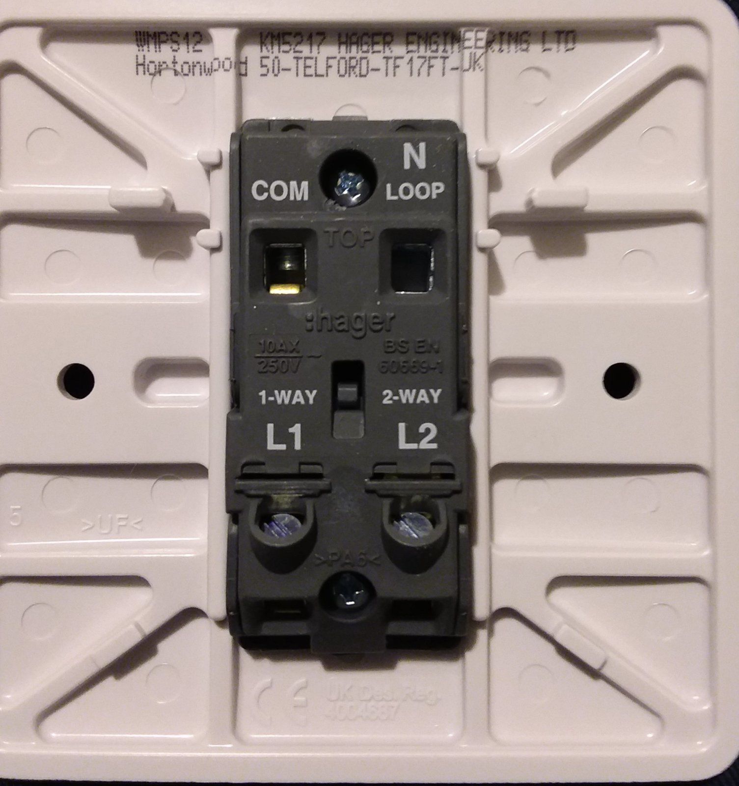

Switches are not provided with an official method to loop inside them, though it used to be common to come across a loft light wired that way. L&N up to switch in the loft, N's jointed with a connector inside the switch box, then on up to the light. It avoided the need for a joint box and looked neater - perhaps that is what they were thinking of?
that's a good point - I haven't seen provision in backbox or switchplate for looping the neutral.
a gnawed-off bit of chocblock isn't a very smart solution.
I haven't seen provision ... ...switchplate for looping the neutral.
Hager...

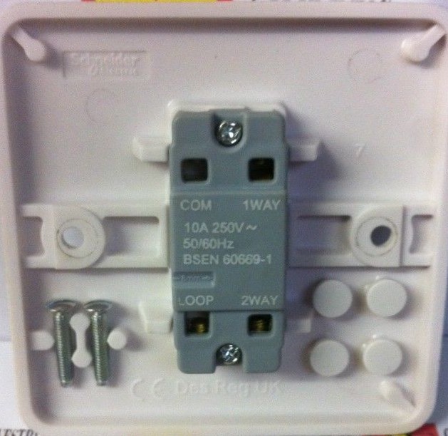

Schneider Lisse do also...
Hooray!
never seen one of those.
That looks like a pretty "universal" lightswitch. Is there a proper name for that sort?
Don't think so, Hager say...
"Unique patented loop terminal allows neutral looping at the switch."
Schneider say(only about the Lisse range AFAIK)...
"Neutral Loop terminal on 10AX plate switches provides flexibility and future-proofed installations."
I think Hager need to drop the "unique" from their description!
