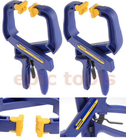

am finding it a struggle to tie down 4 cables in each terminal:
Mini clamps like these can be useful to hold the first couple of conductors still while you wrestle the next one(s) into place
