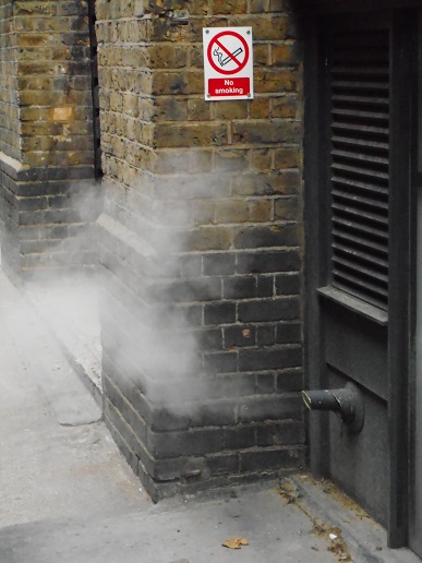

Tony's biggest problem though is not the boiler but location.
Boilers must be fitted no more than 600mm from the floor
