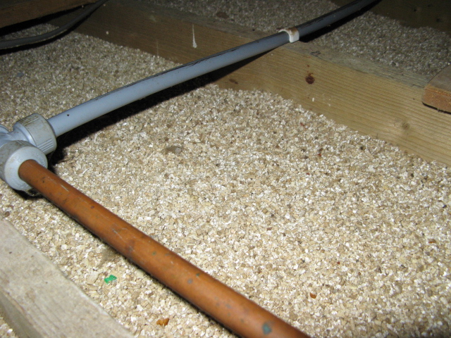

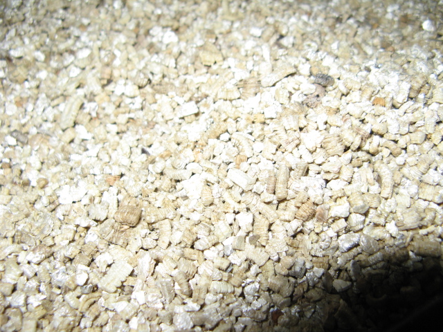

01. “Vermiculite” loft insulation (not sure it is definitely vermiculite, but it is that kind of thing):

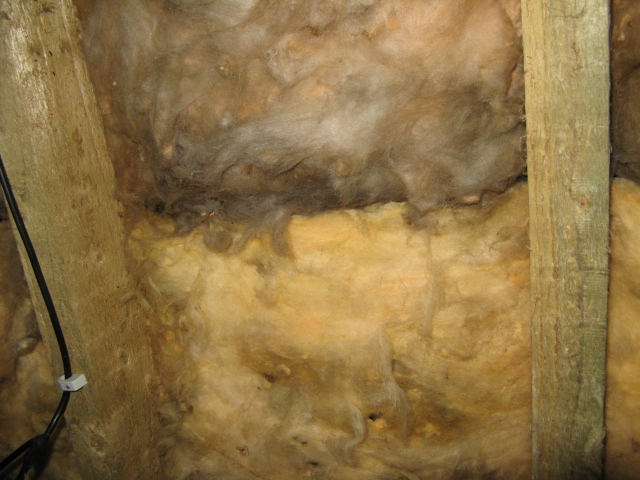

02. Loft Felt Insulation. This is bonded to the roof felt and would have apparently been done so in manufacturing:

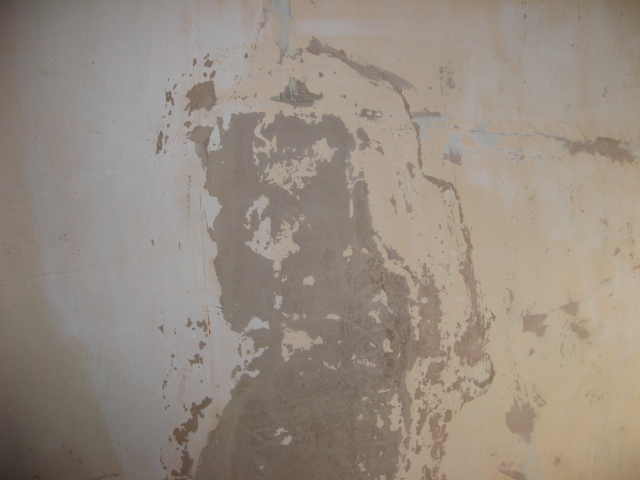

03. Plastered wall, probably done in the 70s (does old plaster ever have asbestos?):

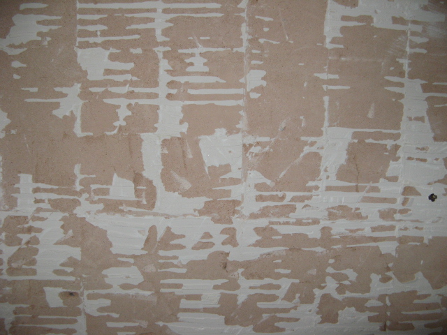

04. Bathroom plaster and tile adhesive… We recently removed the tiles. No idea how old they were. Does that kind of adhesive every have asbestos? What about the plaster beneath?

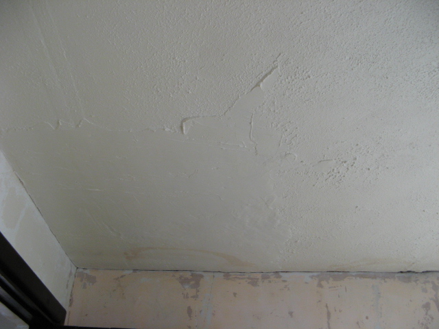

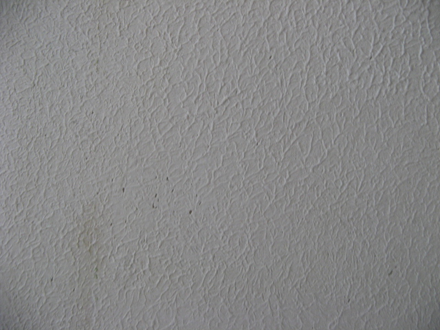

05. Bathroom ceiling artex. Seems a different type to the artex on the other ceilings (see below):

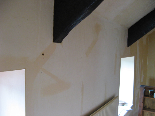

07. Another plastered wall, but this is in the old section of the house. We’ve recently removed the wallpaper:

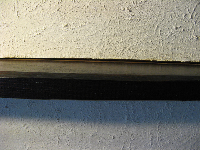

08. Artex in another bedroom:

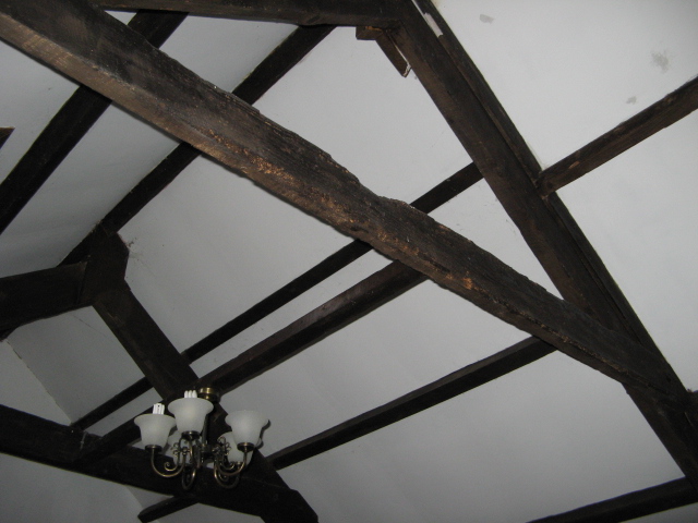

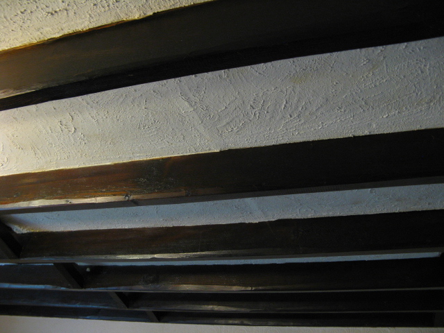

09. Artex on plasterboard panels. The section between each beam is a separate panel (see second photo). Would the artex AND the plasterboard (or whatever) behind it need testing?

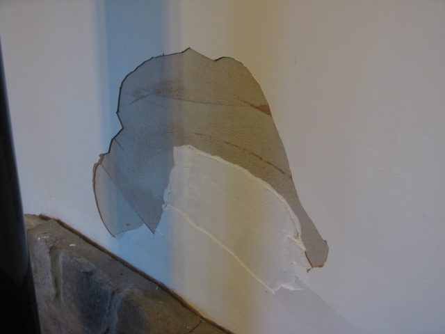

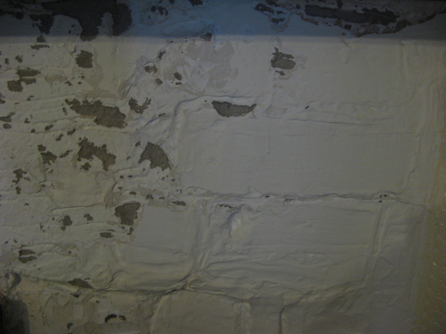

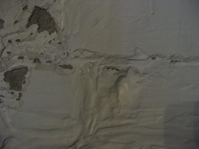

10. Is this stucco? The previous owners covered he fireplace wall in this white stuff and – I’m guessing – ran a finger around it to make it look like old stone work. We weren’t keen and started to hack away at it. Hence why it looks like it does now! So really hoping that this one is not asbestos :( And I guess I’m asking about the “stucco” stuff and the plaster beneath

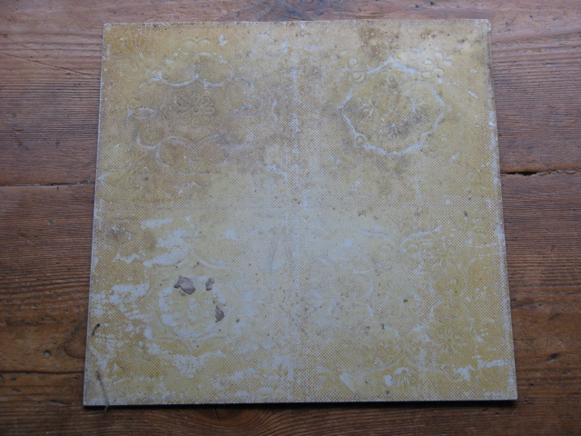

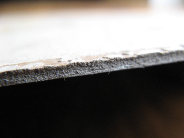

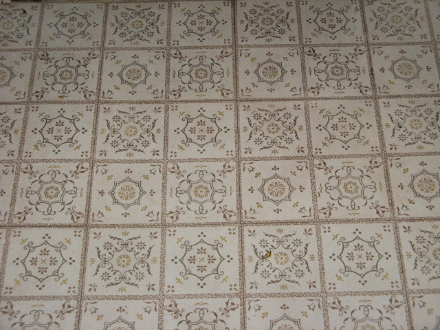

11. Living room floor tiles (was carpeted when we moved in). Aside from the asbestos question, curious to know if anyone knows what they are?

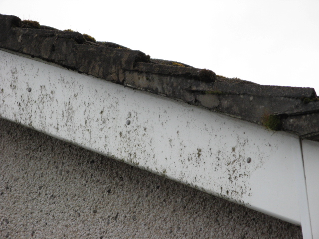

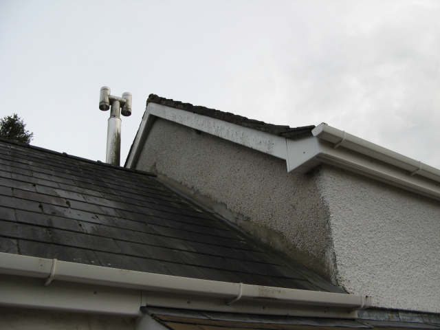

14. Roof undercloak:

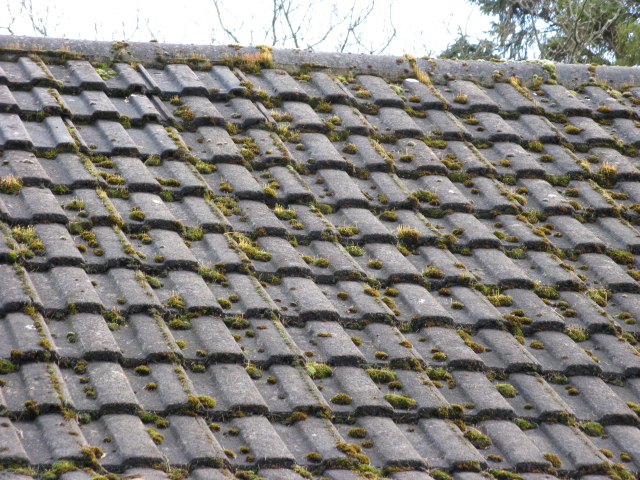

15. Concrete tiles:

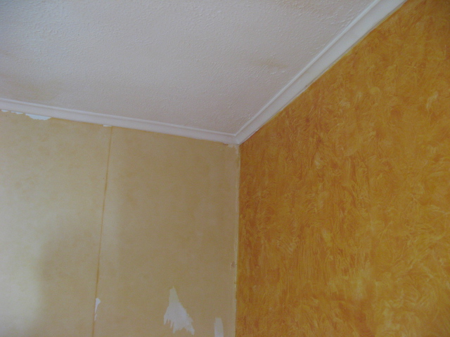

16. Coving. It’s a lot smaller than the coving I’ve seen in the past. Guessing it might be older too…

Image 1 Vermiculite yes this material can Asbestos so called ACM [Asbestos Containing Material] suggest you search on this site for Vermiculite, there was a series of posts here some 6 / 10 weeks ago about vermiculite and ACM. As an aside it looks like Vermiculite.
Image 2. Glass wool Insulation is in itself no risk but from time to time any old bonded paper can have ACM
Image 3 "Plaster" does not generally have any ACM.
Image 4 Bathroom tile adhesive I cannot recall having any ACM
Image 5 / 8 /9/10 [Artex] yes have scrape tests undertaken
Image 7 Plaster as above.
Image 11 I would think it will be OK But?? get them tested, I do not recognise the material especially the raw cut edge?

Image 14 the infill between exposed edge of the tiles will be Sand Cement, as an aside it would be of no risk to you if indeed it contained an ACM. Having said that? the soffit [ the horizontal section between the facia and the wall is often made up from Cement Bound Asbestos.
Image 15 No ACM they are Concrete.
Image 16 Coving, old coving was plaster, modern stuff is plaster or polystyrene, some modern "ornate" can be plaster+ fiber, very unlikely to have and ACM

If the floor tiles are thin and brittle they could contain asbestos but very low risk material. Roof tiles can contain it, some vermiculite from Canada because it comes from a similar location to asbestos and was produced in a factory that also produced asbestos products (more like the "may contain nuts" thing we have these days) Artex unless post 1999 always possible.

1. It's hard to get a straight answer on the vermiculite but from what I've read - and as above - it is only cross contamination that has been an issue and that was in the States... Maybe just test for peace of minds sake. Although I have moved a fair bit of it so if the test is positive I'll poop myself!
10. To be honest, I said stucco in the OP without really knowing what it means! On further reading, I don't think that's what it is. Rather, in places it came off in quite large but thin sections using a chisel. In other places it seemed a lot thicker/deeper and had to be hacked away at. Not sure if that helps! I'm sure someone in the know would be able to tell instantly if they were here.
14. It was the surveyor who flagged the roof undercloak. I can see what you mean though, perhaps only worry about it if or when the roof needs work. With regards the soffits, were you talking generally or about my house as well? If the latter, I can't see where you mean on the photo.
16. The coving is strange. Or maybe not, but I've never come across anything like it. It seems to be almost like a foam material. Or lightweight polystyrene. Very light and if you press with a fingernail it leaves a mark.

Coving sounds like light weight stuff early was polystyrene later paper covered foam do a search for light weight coving to see.:)
RE 10. I've just heard back from the previous owner. She said the wall used to be clad in slate fragments, which she didn't like, so she removed the slate and underneath was just cement rendering. Does cement rendering ever contain asbestos?
After getting it back to the render, she used a poly cell plaster and created the stone effect from that. I'm not sure how long ago. Any chance of that having asbestos?
Big thanks again
If it was a polycell product I have never heard of any of their products containing asbestos and cement render is just that cement and sand.(y)
The correct term is "textured coating" and it matters not if it was made by Artex, Textrite, Polycell or whoever, they all used chrysotile fibres in the mix.
The stuff on the fireplace wall wasn't/isn't textured. It was a very smooth finish which I think she then ran her finger (or something) around to make it look like stone work.
Thanks for the replies
"Textured" coating can be put on smooth. It's not like peanut butter where there are two distinct types.
