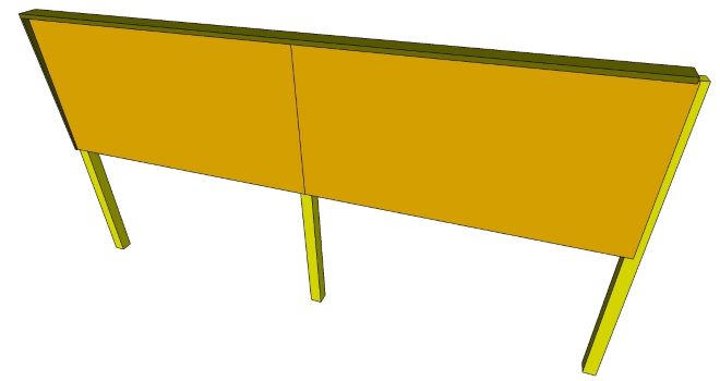

Folks,
I want to build a tennis wall in the garden. I am going to use 3 100x100 posts for the supports and then 3 18mm ply screwed to them.
Is all ply the same if I paint it? Anything better than other for perminent outdoor use?
C
You need a hardwood ply, as opposed to a softwood one, and it needs to be an exterior grade board (what they used to refer to as WBP ply = "water and boil proof"). You will need to pay particular attention to sealing all the edges thoroughly with an oil-based paint or lacquer/varnish. I'd probably add an overhanging pressure-treated softwood lipping to the top and end edges which will further protect the edges from water ingress and damage (see attached illustration). Overall finish should ideally be with an oil-based paint as opposed to a water-based paint - simply because it lasts longer. Some people will doubtless recommend marine grade plywood - all I'll say is good luck trying to find it at anywhere near a reasonable price.

Yes, I was going to add a bead to the edges and top. The top I was thinking of giving a decent overhand of around 100-150mm. It will not protect it all but will stop a fair amount I think.

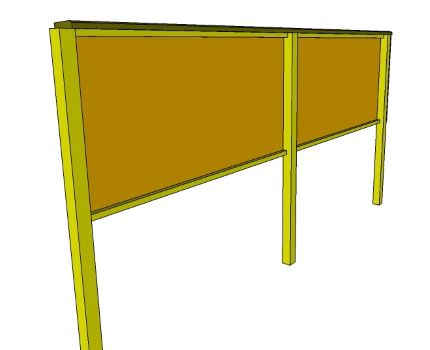

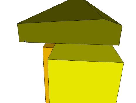

Sorry, bit of a c*ck upwith the drawinghs - missed them off :oops:. Here they are:
Above: Main structure from front showingcaping and tapered end cover
Below: From rear showing 2 x 2 treated softwood perimeter framing (to reduce bowing and stiffen the structure)
Above: Showing the sort of capping needed. The drip groove on the underside at the front is cut by making a 3mm deep saw cut with a circular saw something like 10mm in from the front edge so any water running off the top runs under, hits the groove and drops off. The capping ideally needs to cover the tops of the posts as well so as to protect them from water soaking into the end grain and starting rot. I'd also consider running a bead of silicone along the edges between the cappings and plywood as well as between the plywood sheets to reduce water ingress - it won't last forever, but it will slow down decay

The problem is that if you don't protect the edge thoroughly it will start to delaminate and potentially rot in a matter of months
