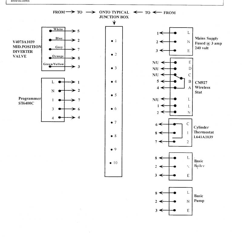

Simond, I've just fitted a CM927 to my system that has an ST6400C programmer. Two questions I'd like to ask:
1 - If I keep the ST6400 how do I set the heating side?
2 - Or should I replace it with an ST9400C ?

There is no need to replace the ST6400 8) :wink:
Terminal 4 on the ST6400C is the CH on terminal, so you should disconnect the lead from this terminal and at the other end. Make the wire safe by cutting off the bare wires at each end. Then wire the CM927 as per its wiring diagram.
The ST6400C will then act just as an HW timer
Thanks for the prompt reply. In the meantime I've had the following diagram sent from Honeywell technical support, the number 4 connection on the programmer is shown connected! Any comments? It also happens to be the way I have my system setup at present.
Can I assume that if I leave it like the diagram then I must set my ST6400C to continuous on the heating side and that the CM927 will then control the heating?
Honeywell did not send me any instructions!
Spot on, just set the CH to permanently on. No wiring mods are needed if you already had a room stat.
Wiring as shown in the Honeywell diagram will work OK, provided you leave the CH switch on continuous/24hr. The only problem is that there are now two switches controlling the CH, the one on the ST6400C and the one on the CM927. If the ST6400C is accidentally turned off ... :?
Completely disabling the CH side on the ST6400C is, I suggest, a better way of doing it. In this case you will need to provide a link between L and A on the CM927.

If you want to retain the ability of the ST6400C to turn off all CH then you do not have enough wires in the T6360.
It is far better to wire from the wiring centre, I suggest if you are not up to it find an electrician or a wiring conversant heating installer. You seriously weren't expecting the wiring centre to be labelled up for a DIY visit ten years later!
You will need to link the permanent live to A in the receiver if you are going to bypass the programmer.
Your colour coding is immaterial, it is what is actually connected that matters. Many a plumber has blown things up relying on colour coding by a previous installer. Don't allow the actual cable colour to convince you of anything.
